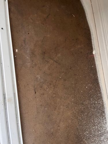

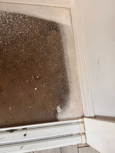

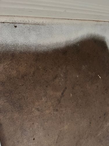

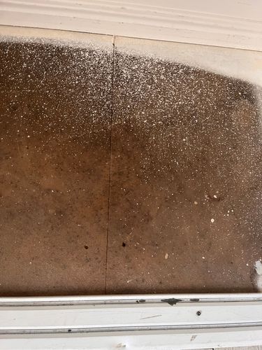

I noticed a bad smell in bottom of closet removed carpet as moulding and sprayed vinegar and water, but still smell, sprayed another mould cleaner , I’m wondering how to replace the bottom board ? Can I do this myself and how or is it something I’ll need a handyman’s help with, the courtyard had been flooding with heavy rains and the outside board is slightly damaged, so I’m thinking maybe water had gotten under room , I’m very limited with funds but I need it fixed so if I can get an idea on how to fix or go straight to a professional, it is very tight under that section of the house and room is against a common wall so no access, should I cut into it to see if it’s underneath moulding or just keep treating the board with mould removal products any advice would help please 🙏

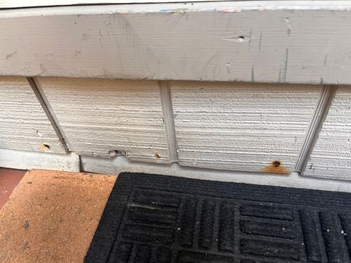

I need to crawl underneath,it’s very hard cause it is on a slope and not much room up at the bedroom area I had a handyman who said it’s a big job and I’m thinking it’s best to get insurance people to assess the situation and take it from there as it’s just going to get worse if it keeps flooding into my courtyard, and up the wall as so close to ground

IMG_9907.jpeg Hi Jacob, thanks everyone for great suggestions, I actually took a video not sure if I can upload it and lots of pictures the floor is all damp/wet there’s a lot of mould growing on joists and a part where there’s some black mould too , I’m in serious debt and , money is a real issue but also my health isn’t great either, I asked the neighbour to please check her downpipes as too much excess water comes from hers o top of mine it’s just a avalanche, she’s finically taken notice of what I say and said she will , insurance is 500 to get someone to come assess and I have to start claim , it’s obviously got bad from the recent weather event and a couple of constant rainy weather events but as this is something that has been happening for a while would insurance even help ? There’s worse pictures but I’m having trouble seeing which ones and need to start working soon , I will need to drawl back under there which is just so small to clean it but it’s the only thing I can think of for now to spray vinegar and throw the rags in bin , any other suggestions will be greatly appreciated thank you,

Hi @angelique5,
I understand the expense might be a lot now, but the potential cost of not taking action could be far greater. The most important thing now is to stop the cause of the issue.
Unfortunately, the only way to know if your insurer will help is to contact them.
Your subfloor is damp, but it doesn't look to be in too bad of a condition. At present the joists and bearers look to be solid, but continued exposure to water is not going to be good for them.
You could use this Air Blower in your crawl space to help dry things out. I'd suggest hiring it for 7 days and running it for as long as possible.
You can use Concrobium 946ml Mould Cleaner to clean the mould off, but please ensure you wear protective clothing including a mask, eye protection and gloves
If you can locate the cause of the leak, I may be able to offer advice on how to stop the leak, but it is likely best to contact your insurer before taking action on this.
