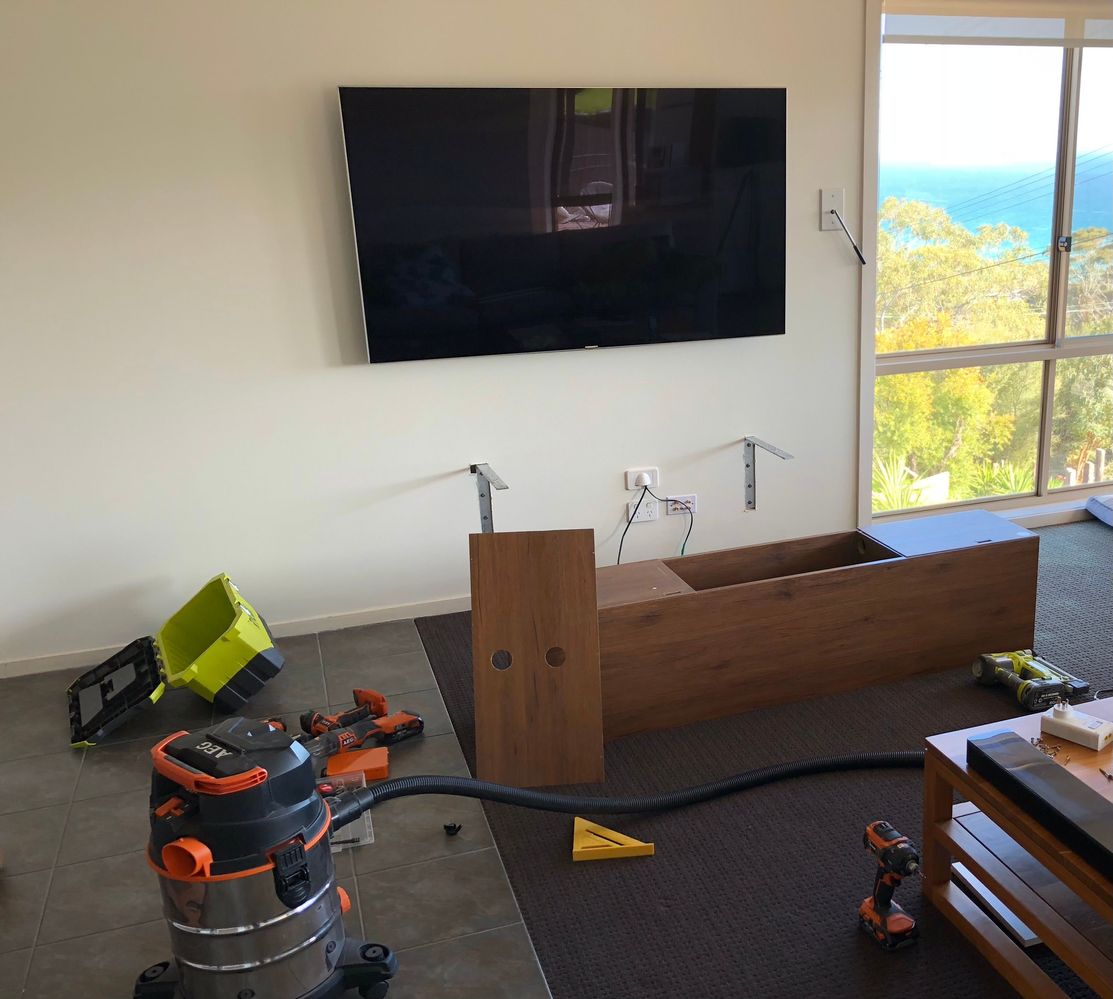

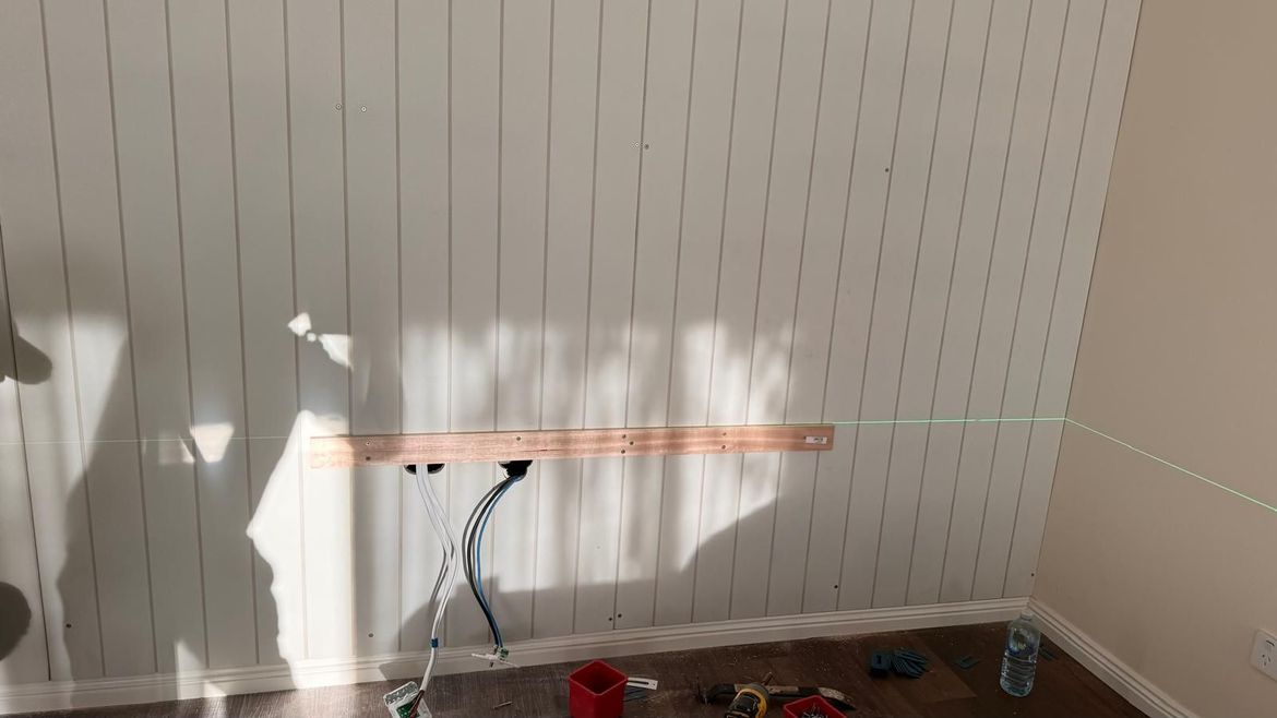

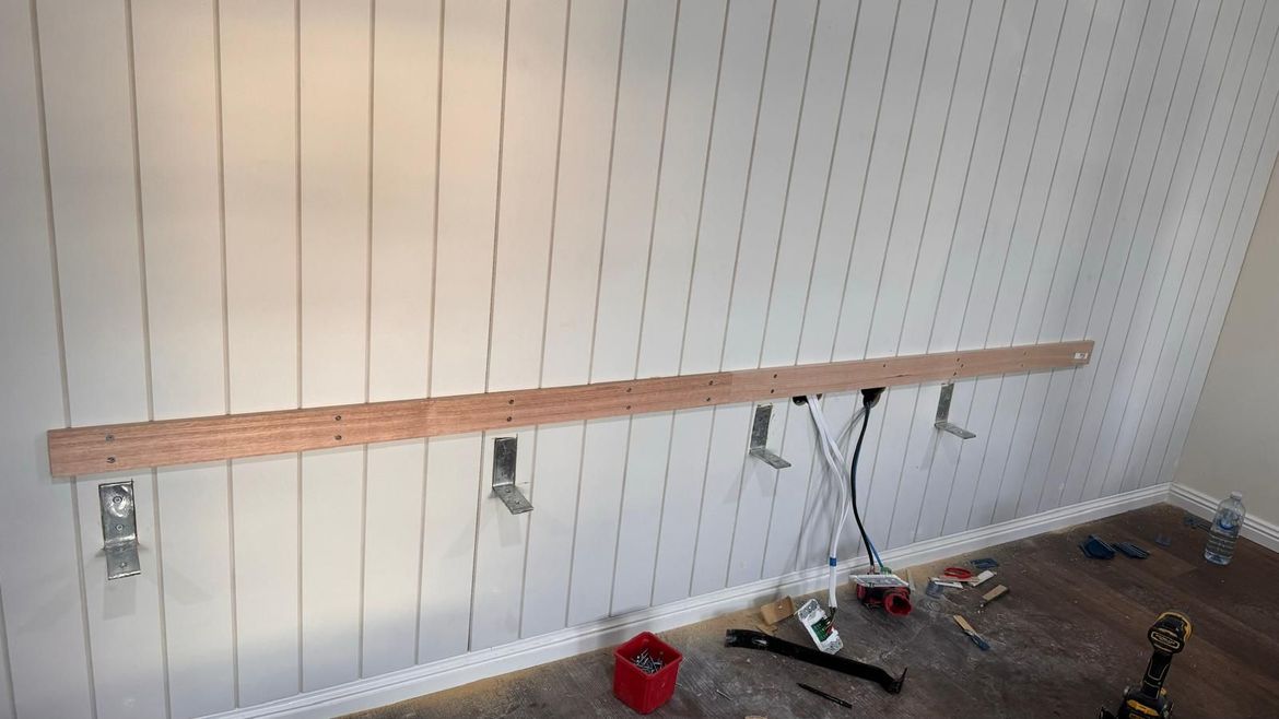

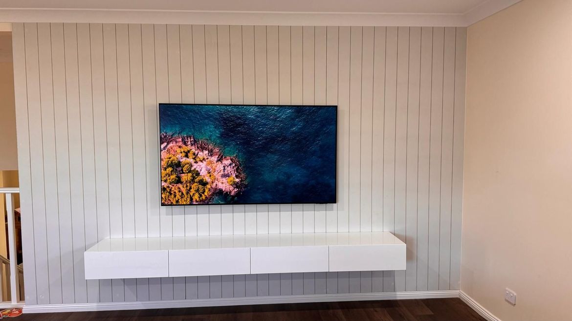

Hello wonderful people of the Bunnings community - Just wanted to give you all a progress update about this project.
I had professionals help me with the VJ panels and install TV cabinets, and they did an amazing job ensuring that everything, especially the cabinet and TV, is secure. As suggested by @MitchellMc, he installed four brackets on the studs where the cabinet is sitting. To secure it further. he also installed horizontal timber on the studs. The cabinet was then flushed with the wall and screwed to both the brackets at the bottom and the horizontal timber (see the pictures). The powerpoints were also moved inside the TV cabinet drawer where the TV one connect box sits to power the TV."
The brackets were so secured that the tradesperson even demoed standing on them (I had my heart in my mouth when he did that). Now, we need to paint the wall and add some lighting to it - I will post a final picture once it's all done.
Thank you everyone for your contribution, without that - I wouldn't have been able to achieve this amazing (and secure) result. On a side, special thanks to @ProjectPete as I took inspiration from his project. I couldn't do the recessed cabinet, but still very happy with the outcome and may consider the recessed cabinet at a later stage :).

Thank you for sharing the update. It's looking brilliant.
I'm a big fan of VJ and this is a great install. It gives a brilliant backdrop for the wall-mounted TV.
It's always good to know that a tradie will back their work, and standing on the floating bench is definitely a theatrical way to do it. I'm sure they'd done it before so were confident it would be fine.
I can't wait to see it after the finishing touches.

:smile: Now that looks great and love the stress test, would def put my mind at ease tho that heart dropping momnet would have been intense! :smile:

Hi @RJ2 thats come out looking awesome, I love the clean lines look and the cabinet really is a standout feature. Looks like they used panels right to each end without any fillers, which looks great! Now to sit back and enjoy 👌
I floated a much smaller cabinet using a similar technique. But I had a very cheap cabinet that I bought and took the legs off. So no heart in mouth situation to worry about.
