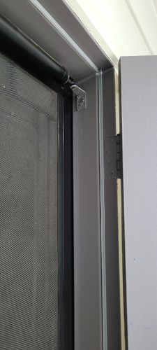

So I finally did this but the door doesn't gets closed like it used to before. Somethings obstructing it. What have I dont wrong here. Attached pics for reference @EricL

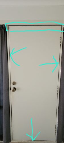

Hello @nsavi
I'm sorry to hear the seals are interfering with your door closing. In the photo where the seals are attached you've placed one of the seals on the large end of the door frame. I suggest moving it to the narrow ledge so that it does not prevent your door from closing properly. I've placed an image below to give you an idea of where you need to transfer it. Please test to make sure the door will close properly.
