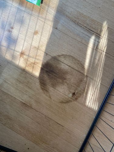

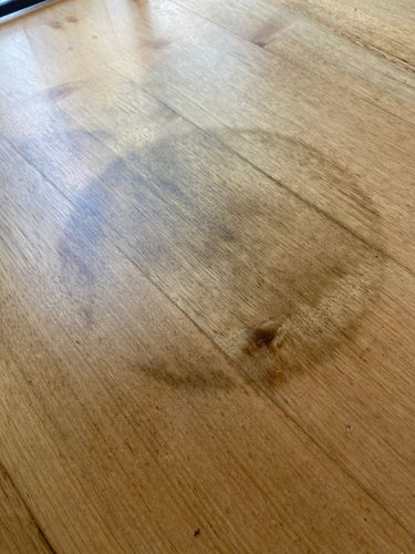

Hi - looking for help as to how we might remove / repair this water stain on new oak hardwood timber floors. Are there any options other than re-sanding & sealing? Thanks

I'd suggest using Diggers Rust And Stain Cleaner, which is an oxalic acid-based product that can remove stains in timber. Please note that it is a light bleaching agent, so you should do a small test in an inconspicuous area before committing to its use for removing this stain.
Follow the instructions on the label closely and ensure you wear gloves and a mask while using this product.
Allow me to tag @arfabuck, a very experienced woodworker to see if they've got any further advice.

I just wanted to point out that if the method suggested doesn't work, you might need to look at having the floor professionally restored, most likely through sanding and re-sealing. The stain has likely penetrated quite deeply into the timber. You might be able to reduce the severity of the stain, but being able to totally remove it is probably not possible.
Before you try the product mentioned above, I recommend you enlist the services of a professional floor restorer to provide a quote on the work. You have a lovely floor; it would be a shame to make the stain worse.
Once again, if you need to sand, I recommend a professional, as what looks like engineered floorboards are not very forgiving of sanding mistakes.
