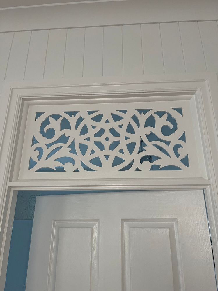

We've got breezeways above all of our bedrooms doors. We love the look of them but our house is really noisy with the timber flooring everywhere so I want to try to figure out a way to put some glass or perspex on it so we can keep the look (and the light) but reduce the noise significantly.
I don't really want to install the glass inside beading or make a frame etc. I would rather not have anything that is permanent in case we change our mind after our kids are a bit older. I also know that these breezeways can collect a lot of dust so I want to be able to clean up the glass or perspex every now and again.
I've got some ideas on how I can do this but I wanted to see if anyone else had done something like this before to get some inspiration.
Thanks

I suggest looking at Clear Acrylic Sheets and cutting them down to size. I propose holding them in place with the use of Rolltrak Clear Flyscreen Swivel Clip - 8 pack. To keep the clip in place, I recommend using Pinnacle 4.0 x 25mm White Countersunk Timber Screw or similar.
Using this method, it will allow you to install and remove the acrylic sheet at your leisure when you want to clean it. You won't need to use tools except for the first time that you install it. After that you simply twist the clip out of the way when you want the acrylic sheet out.
Should you change your mind in the future, the clips can be taken out and the holes filled in sanded then painted over.
