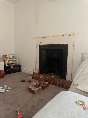

Hello! I’m after some advise as to how to patch in an old fireplace. This was an old gas fireplace which had become a safety hazard for our two toddler as well as taking up majority of our living room wall space so we have decided to remove it and patch it in.
It obviously going to leave a large hole plus damage to the surrounding drywall.
how would I go about patching this in to make it look like a normal wall?

Before you cover your fireplace, I suggest having your chimney or flue professionally sealed off. Any gas fittings that go in the chimney must be professionally turned off and deactivated. Once this is done then you can start covering the fireplace. I see that you've already started with the brick hearth, if the flooring is rough and pitted but not flat, I suggest using Dingo 10kg Mortar Mix to fill the gaps and flatten the surface.

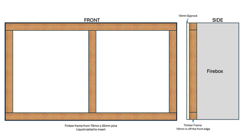

For the front of the fireplace, I propose building a timber frame made from 90 x 45mm Outdoor Framing H3 Treated Pine - 2.4m and anchoring it to the bricks of the fireplace. You can then use standard plasterboard to cover the front and fill in the joints. The final steps will be to sand the filler and paint the surface.

That is an interesting job I do have a question about the metal inset, doe sit come out to the edge of the plaster? From the photo it looks like it stands a little proud of the surface?
My steps would be along the same lines as @EricL and also factoring in @Nailbag 's recomendations. The steel shell is the only bit that concerns me. Maybe in the process of having the chiment capped (as it will be flued to outside) you can ask the easiest way to remove the metal or if it should be removed as it could be supporting brickwork ect.
