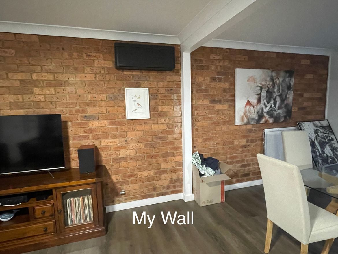

We've got an indoor red brick feature wall in the main living and dining room of my new home. There's potential in the aesthetic, but it needs a spruce up.
We're considering  re-mortaring it with a lighter grey mortar, and doing a light limewash to create a slightly weathered, recycled brick look.
The room is on the darker side with limited natural light, so anything we can do to brighten it up, really.
Picture of the current wall vs what we're hoping to turn it into attached.
Is this realistic? What's the best technique to use? And ballpark timeframe (approx 7mx2.5m wall) I should plan for?

Looking at the bricks themselves that you have I like the idea of lightening the mortar but not of trying for that recyled effect as your bricks are very uniform in colouring and type. You could try painting the mortar itself down below where the tv cabinet is to see how it would look?
The whole wall being painted a light white might give you a closer look to the examples you have shown. (test behind the tv cabinet :smile: )

I really like your finished target and definitely feel this is doable. It's going to make a mess and will need a lot of drop-sheets but my first job would be to use an angle grinder with a masonry grinding disc to increase the depth of the course. This will then allow you a choice of coloured mortar to refill the courses and still have a recess.
Next step would be to apply a masonry sealer so that your layer of a water-based wash-wash to your preferred level of finish can be applied.

I see what you are after but I'm not convinced it is easy enough to do or that you will achieve the look of the 2 photos you show.  The photos show reclaimed brick or very old irregular bricks, which isn't what you have.
If you want to lighten up the space then I would suggest you just paint the brick in full, or cover with VJ panel as a feature and paint that.
