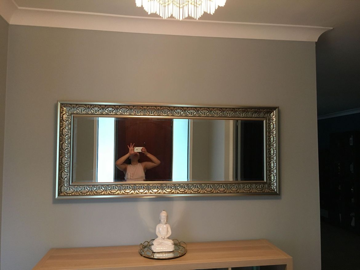

I use stud on the left side of the mirror and I used this product: https://www.bunnings.com.au/ramset-wallmate-twist-n-lock-4-pack_p2260138
on the right side (because the mirror support did not fall on the stud). The total weight of the mirror itself was 13KG. It looks nice and firm. I think it worked for me.

That looks stunning. Well don!

@Serveh - nice project. May I know where did you get this mirror? It’s just gorgeous.

Thanks for joining the discussion, @Serveh really does have a gorgeous mirror don't they? I had a quick search and found that if I use the terms vintage ornate bevelled rectangular mirror I was able to find similar style mirrors. Do you have a particular wall you are thinking a mirror like this for?
