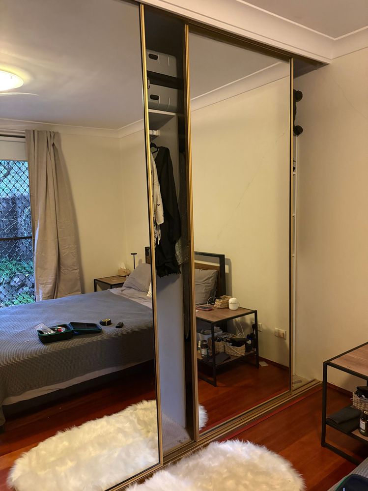

one of the sliding doors on my wardrobe is stuck looks like the wheel in the base has come off. I tried to fix by inserting it back and not sure if it is broken or just not inserted. How do I fix this?

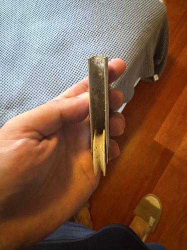

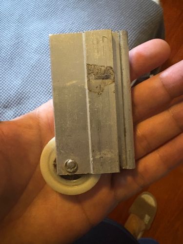

Hi Mitchell, Thank you for your help with this. I have taken some more pics for you to look at. The mechanism looks pretty simple to me but the wheel does not stay in the carriage I have tried tightening the screw from the top but looks like it does not even come in contact with the base.

It looks like the carriage sits over this piece; however, I don't see how it would attach to it.
Does the screw make any part rotate or expand? It looks like the nib that is about 5mm below the screw might rotate when the screw is turned. Is that correct?

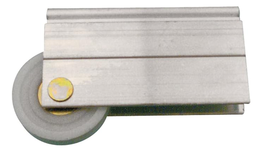

This looks like a Prime-line roller assembly. The web site has the dimensions and if it doesn't match you will easily be able to return it for a refund.
And that screw should wind down to push the aluminium section under it down on to the roller assemble. It uses gravity to lift the wheel as you turn the screw the other way. It's not a great system, but an old one. But if it's just the wheel axel thats collapsed then you shouldn't need to make any adjustments once the assembly is replaced.

I saw your sliding mirrors and went "They are mine" lol
Just had a look at the rollers on my mirrors, similar but not the same 😕 The premise that @JacobZ has suggested sounds sound, especially withe screw adjusting the wheel. (mind is a lot more obvious)
Looking at the photo of the removed wheel it kind of looks like the wheels pin is off center? If that is the case then that could be why the wheel is loose.
I know the doors are HEAVY, so if that bearing of the wheel has moved out of teh housing I can easily imagine it jamming. I also remember having a tine stone (blue metal piece) caught in the base of teh V of the track. You track looks a little differant but still a stone could be unseen and cause it to jump out?
