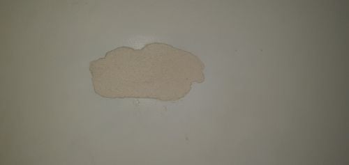

I had a command hook up with a picture that fell and ripped off a good bit of the paint back to brown im guessing plasterboard just wondering what do i need to do to fix it and repaint i am hoping just this section. I have lightly sanded the loose bits of paint off.

You'll need to apply a thin coat of filler over the area where the paper has been torn away. This is to fill the depth of the missing paper. Once the filler has dried, give it a quick sand so it is flush with the surrounding area, and then prime it before painting. It's important not to skip the priming step as you need to seal the porous cement-based filler.

Thank you. Do i need to use primer before i use filler? A couple of videos i watched they said to use primer first then filler.
Also does it matter which primer i use as in water base/oil base or shellac base?

I'd be inclined to apply the filler first so it can grip onto the exposed paper. If you seal the surface first, it might prevent the filler from gripping adequately.
Given that you are most likely going to use a water-based wall paint it would be best to stick with a water-based primer. Whatever product you use, just check on the can to ensure it says you can use a water-based top coat.
