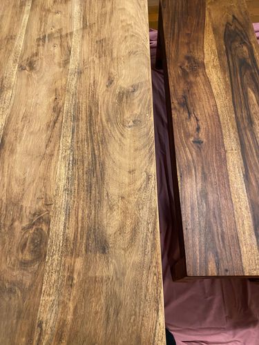

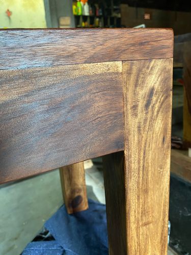

not sure how helpful these pictures are, but chairs certainly feel tacky to the touch. Have tried sanding a small area however the sand paper quickly becomes clogged and unusable.
Thanks in advance for any advice.

My apologies for the late reply. There are a few reasons why varnish doesn't dry off. First is temperature, varnish is best applied at 25C at 50 percent humidity. Cold temperatures tend to delay the drying process, continuous cold days will extend it even further. Next is humidity, if there is too much moisture in the air, this also retards the drying time.
Timber is a natural product and sometimes you'll get one that has large pores in them. These pores tend to absorb the substances painted onto them. A good example is your chopping board. If it is made of mixed timber, wiping it with a wet rag produces different results. Parts of it absorb the moisture and go dark, others stay the same as the water is not absorbed. It just so happens that the timber in your chair has large pores and has absorbed the varnish giving it that darker wet timber look.
To remove the tacky varnish on your furniture, I suggest wiping it with a rag with turpentine. You'll want to wipe the varnish off, don't rub it in a circular motion. Leave the chairs in a windy/sunny part of the house to dry off the remaining varnish. However, if temperatures are staying on the cold side, I suggest using an electric heater to artificially heat a room. Use a dehumidifier to lower the moisture in the air. Please remember to keep it at a nice balance. Overheating and overdrying produce the same result and that is a dry surface but a soft undercoat.
On your next attempt, I suggest diluting the varnish. Please keep an eye on the temperature to make sure you're not running into successive cold days.

Hi @gapliving frustrating to encounter this sort of problem. I had the same thing happen a few years back when using some 'Black Japan' stain on an old timber table. It just refused to set.
First off... you mentioned about the colour. In my experience any of the oils or varnishes, even clear ones, will slightly darken or enhance colours. Just part of the penetrative & sealing process. Feature not a bug as they say...
@EricL touched on what I believe is the right area - humidity & moisture. After it's been very wet or humid timber does stay moist. You can't tell this to touch but it will be holding moisture for sometime. This isn't any great issue with water-based products, in-fact over the years I have talked with some paint experts who say it's an advantage as this tiny amount of dilution actually improves penetration & therefore bonding.
Problem is with oil based products, those that need turps clean-up, the moisture prevents bonding and drying and this can then be amplified if the ambient humidity is still high. Both of these things are what happened with my Black Japan DIY mess...
Not quite sure what the best solution is I'm afraid. Can you move them to an area where they can dry & see what happens?
