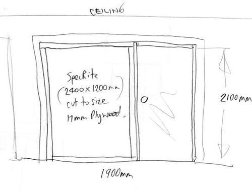

I'm wanting to extend the height of a new hollow internal door. Distance and width below. When the photos were taken - it's just sitting on the floor with no clearance yet. I have an assortment of tools including a thicknesser - but I'm hoping not to have to use it.

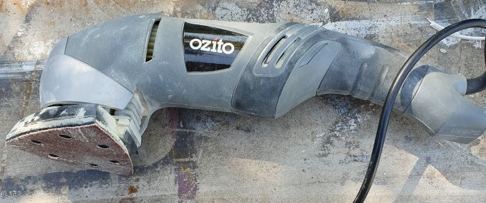

It's a wonderful product @EricL. Wish I'd known about it before. And beautiful to sand.
I'm using an Ozito detail sander - and loving it. Much, much better than a multi-tool with a sanding attachment.

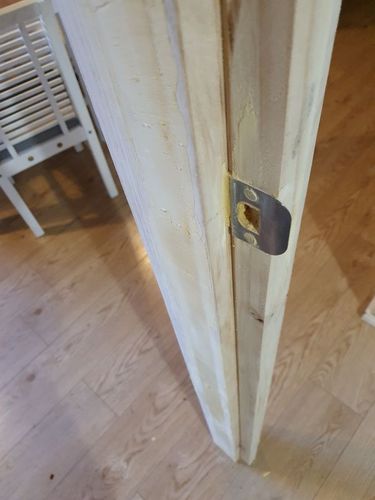

Attached with Kreg screws.

I'm now thinking of making the SpecRite (right product name?) board a blackboard.
It has a sort of polished surface - it would need to be heavily sanded prior to painting?
Re: How to extend the height of an internal door?
Hi @Noyade
Was it this SpecRite 2400 x 1200mm 17mm Plywood Pine Film Faced Non Structural panel you were planning on using? If so, you would need to key the surface to allow the paint to bond. Adding a cross-hatched pattern with 120-grit sandpaper should be sufficient, or you could potentially use Dulux 1L PRECISION White Maximum Strength Adhesion Primer. However, they still advise dulling any sheen level with sandpaper before applying the primer.

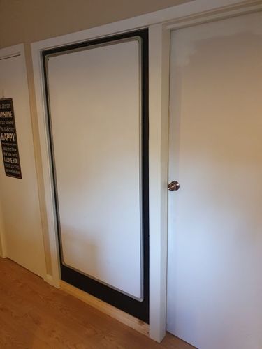

Thanks for the above advice - but in the end I went and found at the local Tip Shop a large White-board which masks most of the ply.

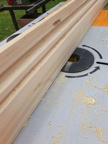

I went to Bunnings early this morning to get some matching skirting - but only needed 1 metre.
It was MDF and 5.4 metres.

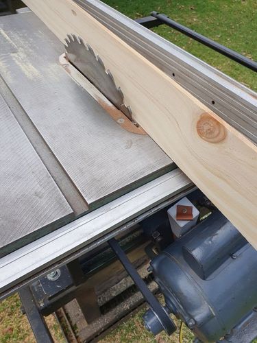

So I had a go at making a piece from leftover pine.
Angled cut...
With a bit of routing...
Still got some painting to do yet.
Cheers.

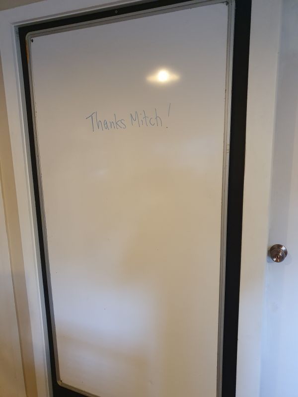

Beautiful work, mate! (@Noyade). So, can we expect all your terrific sketches to now be coming directly to us from the whiteboard? Or, will it purely be used for other more mundane tasks like the creation of shopping lists? I'm sure your other half would be elated for you to dedicate this space to your technical drawing contributions for the Bunnings Workshop community. You could make a real feature out of it, you know?
Well done, and many thanks for sharing the results with us.
Home Improvement Guru
Morning @MitchellMc
Thanks Mitch.
I've already started the doodles. 😁

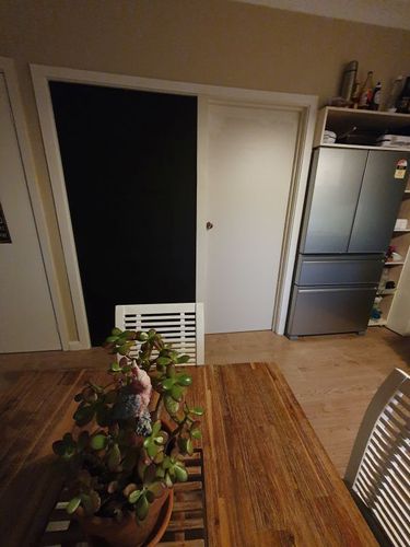

But I'm finishing off the painting this morning.  Door outside in its jig - ready for the final coat.

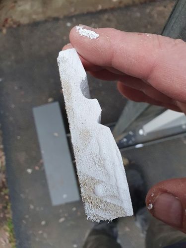

The amateur profile I cut...
