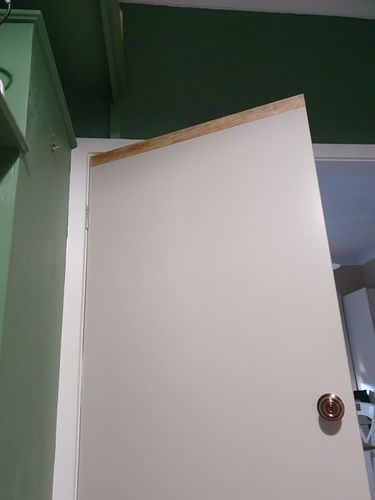

I'm wanting to extend the height of a new hollow internal door. Distance and width below. When the photos were taken - it's just sitting on the floor with no clearance yet. I have an assortment of tools including a thicknesser - but I'm hoping not to have to use it.

Thanks for the wood tip - the size worked a treat. I don't know why, but I had thoughts of having to wander around the wood section looking for dressed hardwood to fit.
I just ripped it to size and length. With a poor shoulder, I found it easier to space the bottom of the door and work upwards, so I will now need to instruct anyone who enters the house to keep their eyes to the floor. 😁

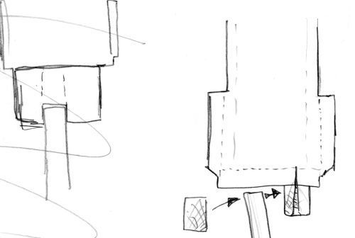

I now need to make a 'fake' door jamb. I want all this to be removed at a later date - call it a temporary bedroom door/wall encasing an old living room area entrance.
If you took a cross-section of a typical internal door jamb - what would it look like?
Cheers.
There are a couple of different styles @Noyade. One's a solid rebated piece of timber and the other has a stop trim piece nailed on.
Thanks @MitchellMc
I'm gonna try making your profile seen on the left, but outta inexpensive pine. I don't expect a perfect finish to paint - but what filler do you recommend for the glued spaces and wood irregularities?

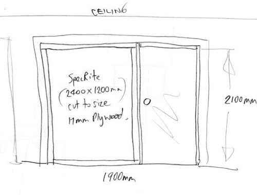

A couple of doodles of how I'm filling in an opening with a 'fake' wall and door.
Hopefully to be taken down at a later date.

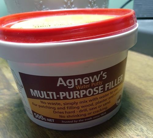

Fitting SpecRite
I'm gonna try this. Never seen a powder form before. I live a sheltered life.
Hi @Noyade
Just a friendly reminder not to add too much water. Keep us in the loop and tell us how it performs.
