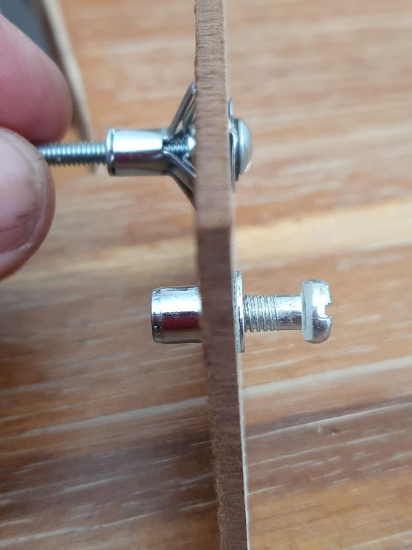

Good morning @algenebautista
I have used two methods which have worked well for me on hollow door thin Masonite, which is around 4mm thick.
Aluminium nut rivets and expanding hollow wall anchors that can accommodate 4mm thickness.
I know you're not keen to drill holes in the door, so be warned - the M5 nut rivet requires a 6mm hole and the M4 expanding anchor - 8mm.
Just a thought. See what you think. 🙂
