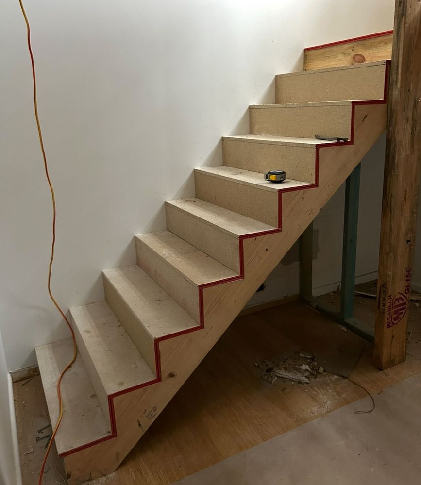

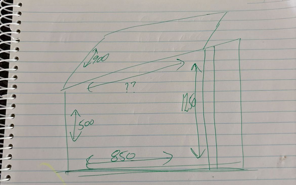

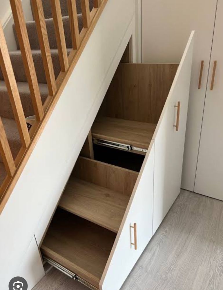

I need some help designing under stair storage. Ideally I would like hanging space in the tallest section and two storage compartments on rollers with shelves. The aim is to optimise space. I have attached some ideas I have found online. I am grateful for any advice or helpIMG_6242.jpgIMG_6243.jpgIMG_6244.jpgIMG_6245.jpgIMG_6246.jpgIMG_6247.jpg

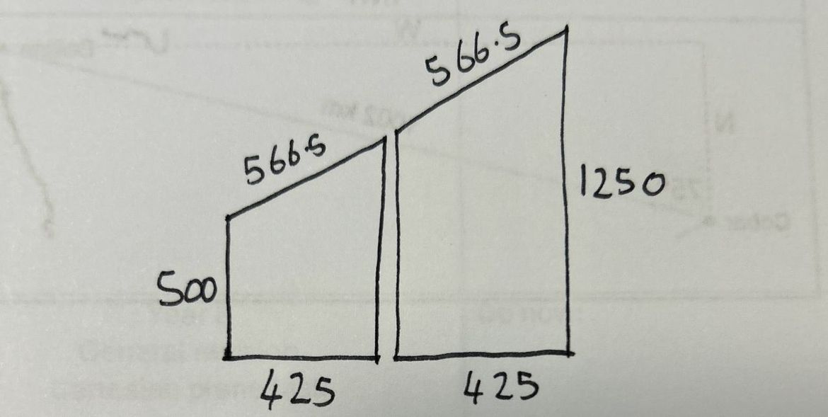

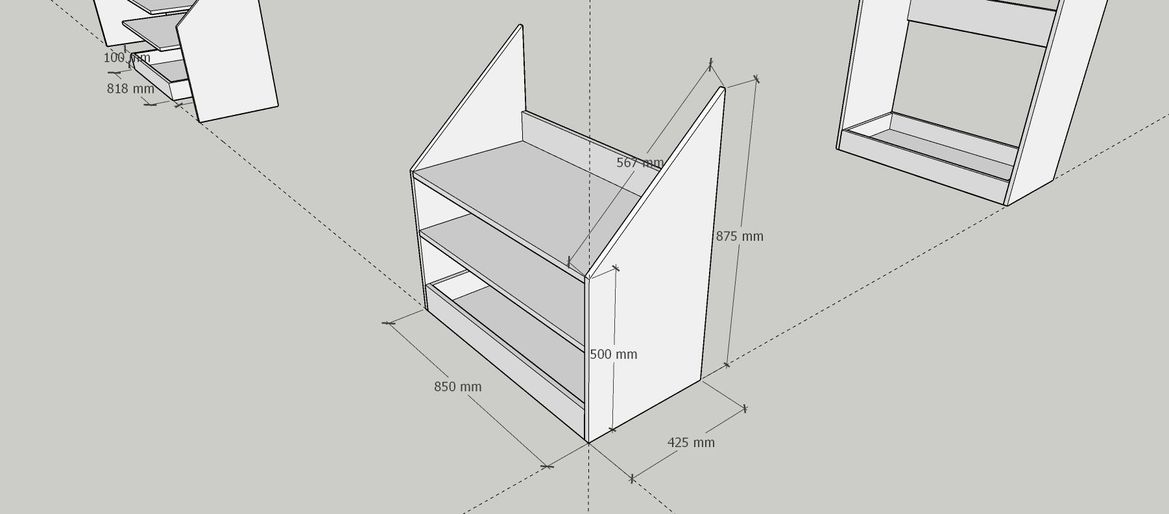

Hello @LauriannGriffin
My apologies for the late reply. Here are the sample sketches for your storage cabinet. Please note that the measurements are for reference only, please adjust them to your needs. Remember that you can change its configuration or add more shelves if you want to. My best advice is to choose your roller castors first before you begin designing your own storage cabinets. You can choose either MDF or plywood for your construction material.
Laurian pull out storage 1.jpgLaurian pull out storage 2.jpgLaurian pull out storage 3.jpgLaurian pull out storage 4.jpg
