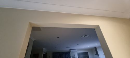

Hi
Apologies I should have ask and clarify this first instead of jumping to stud and bolt.
Barn door and support header is to be installed on a concrete wall.
Wall thickenss is 110 mm
Sharing the photos of wall from both sides
Please advise what is the best method to install the support header and share link of prosuct to be used.
Thanks
Hassan
