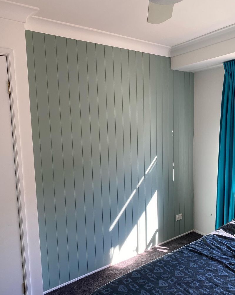

When installing sheet materials over brick or concrete it is always best to batten out the wall with timber or furring channel. In your case, timber would be better as EasyVJ is typically installed with brad nails and glue.
My suggestion is to install 70x35 Framing Timber, with the 70mm side flat on the wall. These can be attached at 450mm centres using Ramset 8 x 50mm Blue Wall Plugs Blue and Zenith 60mm Galvanised Countersunk Rib Head External Timber Screws.
Once the battens are installed, the EasyVJ can be installed over the top following the method set out in their installation guide.

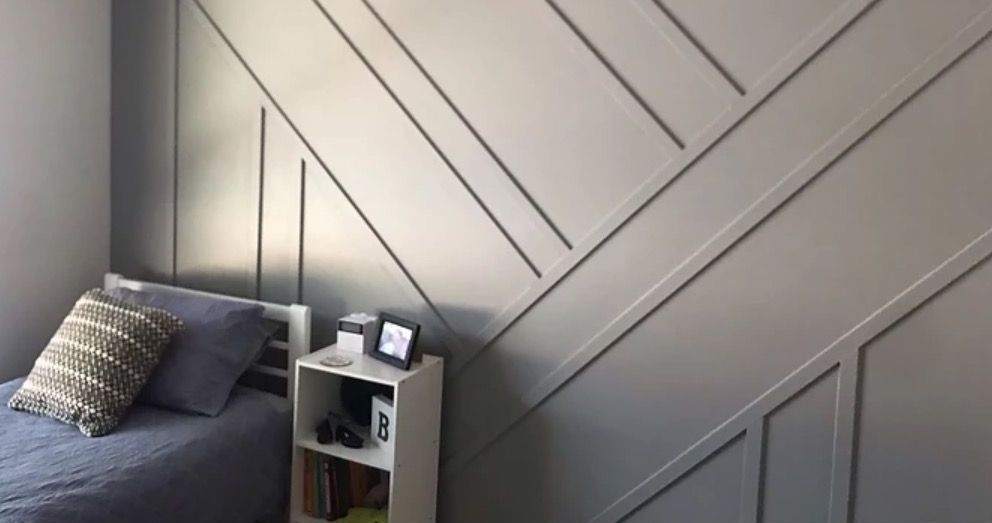

Would I have to do the same if I were doing a Timber panel wall, or strong liquid nails that could be used and taped to hold it while drying? timber panel.jpeg

Unfortunately, there is no advisable method of installation for timber or MDF sheets over a brick wall that doesn't involve timber battens or furring channels being installed between the sheet and the wall.
There are several reasons for this, the main two being moisture issues and differences in thermal expansion.
Brick walls can be prone to moisture and dampness, especially if they are exterior walls or lack proper waterproofing. MDF is highly sensitive to moisture and can swell, warp, or degrade when exposed to it. The glue used to attach MDF may also lose its effectiveness in damp conditions.
Thermal expansion is an issue because both MDF and brick expand and contract with changes in temperature and humidity, but they do so at different rates. This differential movement can cause the adhesive bond to weaken over time, leading to detachment or warping of the MDF panels.
If you are looking to install MDF or timber panelling, the only method I can comfortably advise is to batten it out.
Another option you could consider is attaching a moisture-resistant plasterboard and then creating your features using timber or MDF mouldings. You might like to check out 3 ways to create a feature wall and 5 feature walls with wainscoting for some inspiration.
Moisture resistant plasterboard such as Gyprock Aquachek can be installed directly to brick walls using Drywall Masonry Adhesive. You could then attach timber battens to the plasterboard using Liquid Nails and brad nails to create a feature similar to the image you've shown.
