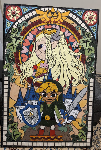

A while ago (pre covid / 'the before times'), I fashioned a ceramic mosaic on some 800x1200x5mm MDF board. It was my first project of the kind and I didn't really think far ahead in terms of how I would like to eventually display it. Initially I had planned to mount it directly on the wall, but as the project neared completion I realised just how heavy it was and how that was likely to be infeasible. With all the tiles, grouting etc, the piece weighs just shy of 21kg.
I have recently moved into a home of my own and I would very much like to display it on my wall. Before the project was completed, I screwed&glued the MDF board onto a basic backing frame built from 30x70mm pine beams, per the diagram below.

Hi Luke (@lukeazadeo)
Let me also extend a very warm welcome to the Bunnings Workshop community.
Fantastic work on the Zelda mosaic. You must be a big fan of the games. It looks marvellous.
I would encourage you to hit the Start a discussion button again and share some more photos of the piece and some detail about how you put it together. We have a lot of keen mosaic creators in the community and I'm sure they would be inspired by what you have done.
