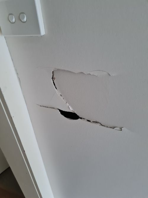

Re: Getting your kids into D.I.Y.
Well - No.2 son and I will be repairing the wall he punched. Quality time together. 😁
Hi @Noyade
The damage does not look too bad, I believe you can use the same panels to repair the damage. I propose putting some timber supports inside the wall and screwing the broken pieces on top. Please make sure to post an update before painting the wall.

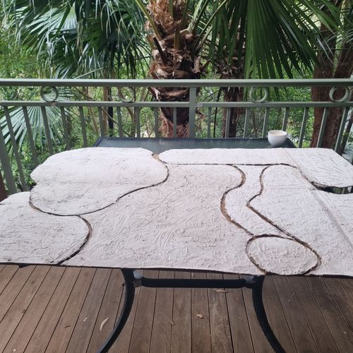

Hi @Jason
Working on an art project for the final touches of upcoming reno

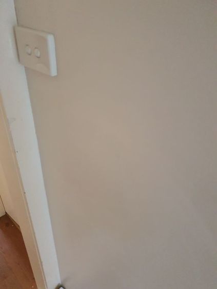

Hey Eric @EricL
"Please make sure to post an update before painting the wall."
I ended up using a multi-tool to cut a section out (it's fibro) and glue a sheet of wood to the back using the old 'string method'. Then a fibro cutter to create a graft to match the shape and thickness. All gaps filled.
This is prior to painting...
(Now - to organise anger-management classes)
