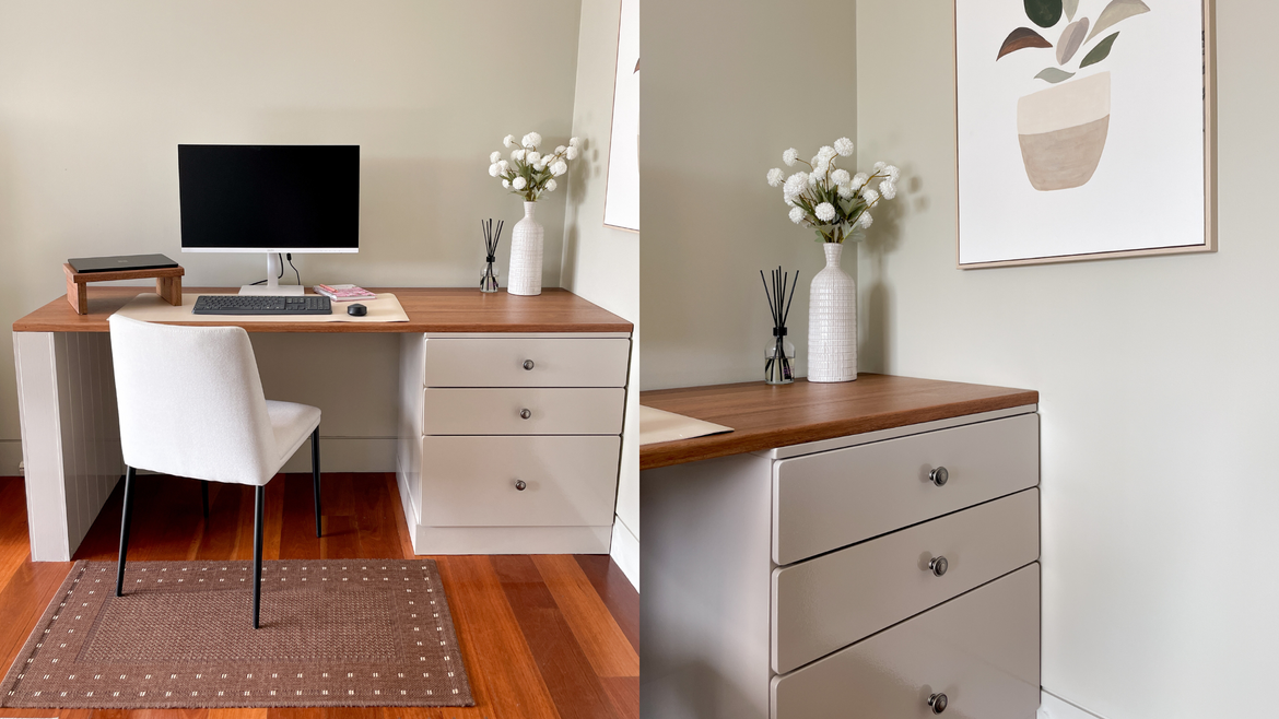

After moving house and finding myself with a bigger WFH space I was excited to create a more functional and beautiful home office nook. High quality desks from a furniture store are quite expensive and I really couldn’t find anything I liked that offered a decent amount of storage and plenty of desktop area. Using Jenna Sue Design’s work/playroom renovation as inspiration I decided to build a custom desk using IKEA drawers and a timber project panel.

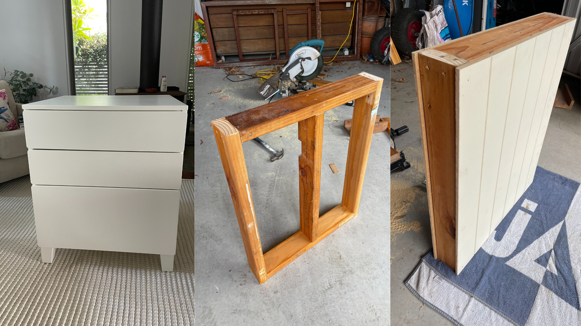

1/10Start by assembling your IKEA SMASTAD / PLASTA drawers.
Step 2
2/10Now onto the build. To hold up the opposite end of the desktop we built a simple frame using 90x35mm framing timber. Here you will need your mitre saw (or circular saw) and timber screws (or nail gun if you have one).
Step 3
3/10We then cladded the frame with VJ panelling leftover from another project. This is a great way to use up offcuts! We used screws on the internal piece so that it could be removable and allow us to attach the frame to the wall and also the desktop. We attached the external panel using pin nails.

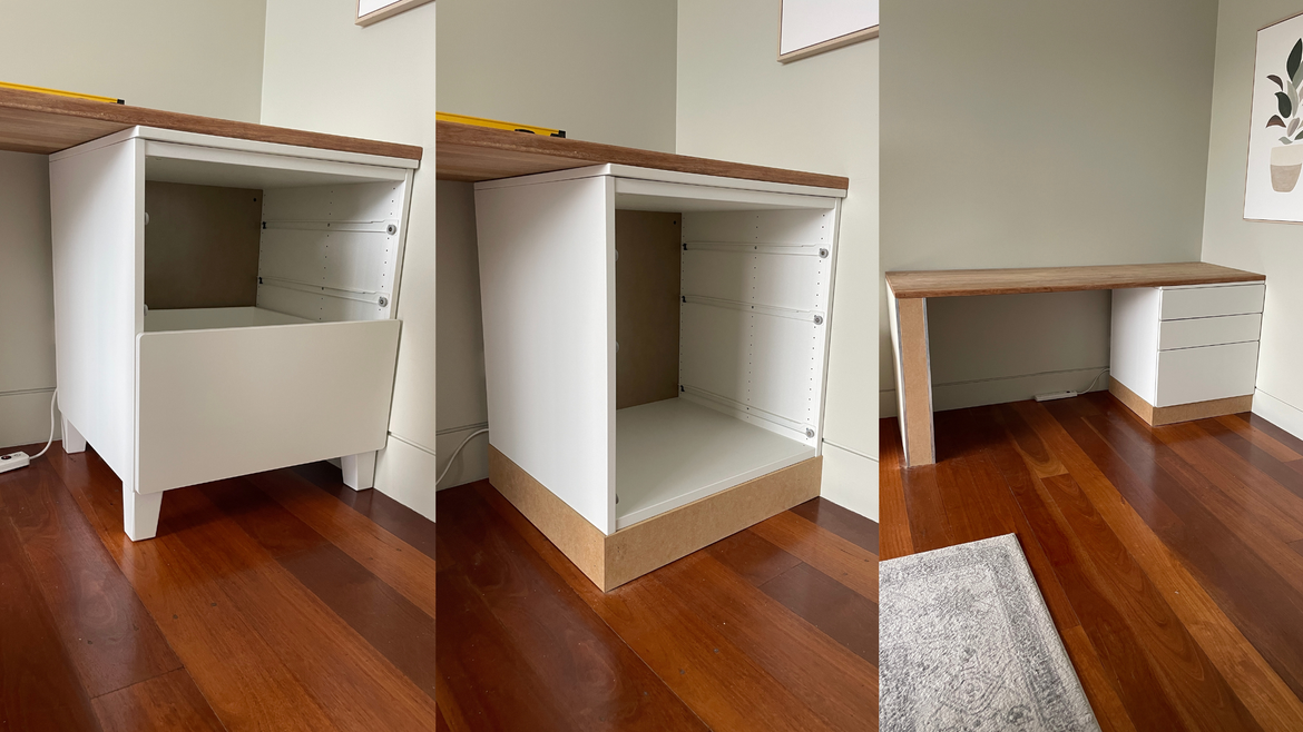

4/10Cut your desktop to size using a circular saw and attach the desktop to the frame and the drawers from underneath using timber screws.
Step 5
5/10To finish the front of the table ‘leg’ we simply used a piece of VJ panel but installed it with the back side facing out. Using silicone sealant, we installed aluminium trim to finish the edges.
Step 6
6/10To create the baseboards and give the IKEA drawers a built-in look, we also used pieces of VJ panel installed back side facing out. We cut the pieces at a 45 degree mitre for a more seamless looking corner join. We nailed these into the drawer legs using small pin nails.
Step 7
7/10Use paintable caulk to fill any gaps e.g. between the baseboards and the drawers, and along the aluminium trim.
