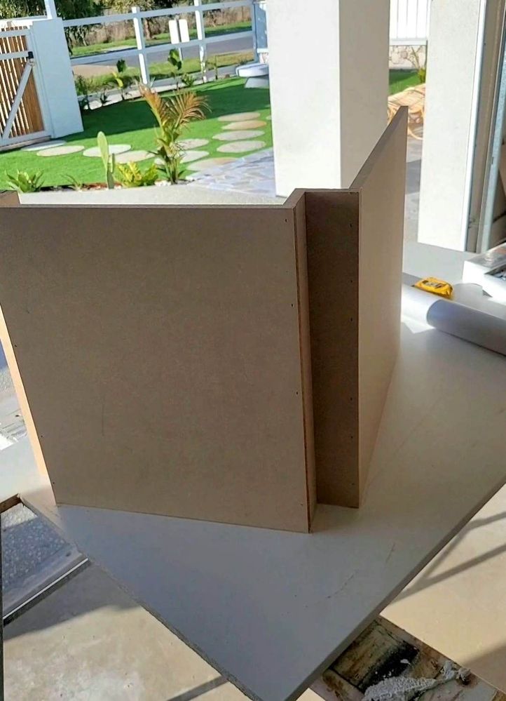

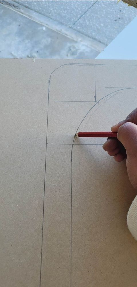

1/7- First up measure up the space you have for your bedside table and work out your overall width, height and depth.
- From there calculate the measurement of your top and L-shape cutouts
- The inside of the L shape should be about 59-60mm which includes the diameter of the pipe and the 4-5mm rebate

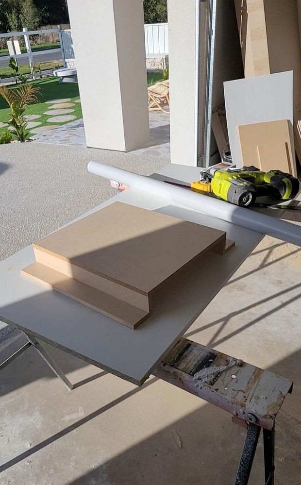

2/7- Next up, add your sides
- Use pins and MDF glue for everything
Step 3

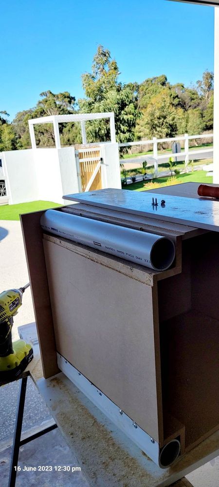

3/7- Add your base and back for more stability then place the pvc pipe and cut it to size
- Using your router, add 2 rebates to each edge (as per the photo below). The depth of the rebate should be about 4-5mm. 3mm for the corflute and 1-2mm to allow for the screw head. You want the screw heads to sit just below the level of the mdf board.
- We've used Pan head screws

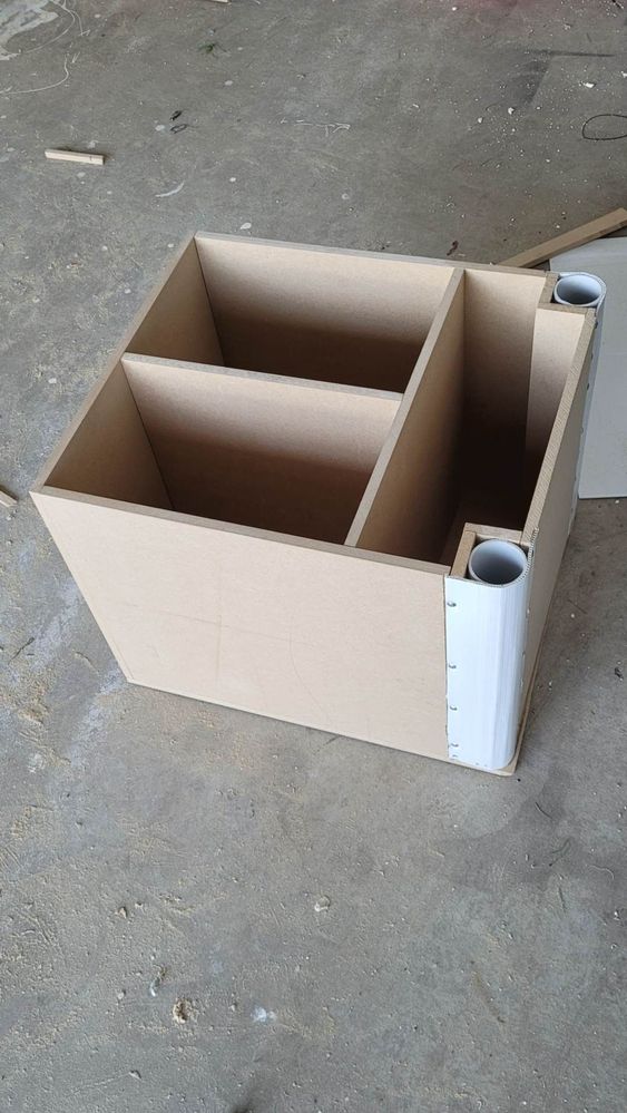

5/7- Once you've finalised your front fascia, you can then work out the size of the fixed shelves and your vertical division.
-The vertical division should sit centre to the middle spacing and the fixed shelves should end up flush with the top of the spacings so there are no steps
- Another suggestion would be to assemble the vertical division and fixed shelves as one piece and paint it first before adding it into the box.
- Then pin and flue from the outside

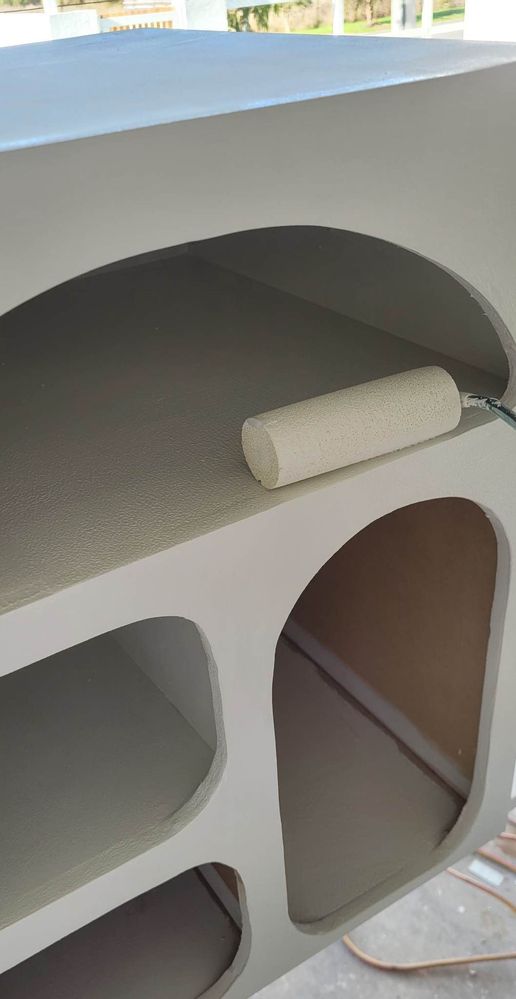

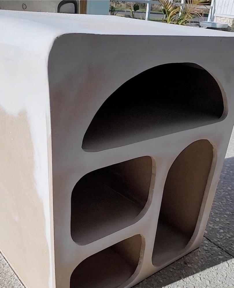

- Using a flush router bit, cut off all the excess around the back and the front, add a bit of gyprock to the joins and sand everything off.
Step 6
6/7We really wanted to have a textured finish, so we've used a 100mm foam roller to paint, it came up a treat!

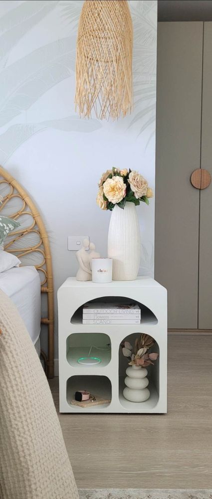

7/7And here you go, the finished product below 😊
