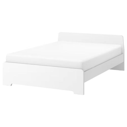

Thank you Mitchel! This is the bed I’m wanting to use, it’s a double bed from IKEA.

Thank you for sharing the image of the bed. Elevating a standard bed into a bunk or loft configuration can be a complex project, particularly when using furniture not originally designed for that purpose. Safety should always be the top priority, especially if the bed will be used by children.
I recommend starting by consulting the manufacturer or referring to their product guidelines to confirm whether modifications like this are feasible and safe for the specific bed you have. The manufacturer may provide critical information about weight limits and structural considerations.
If they confirm that such a conversion is possible, it would be best to engage a qualified carpenter or builder to construct the supporting frame. This ensures that the frame is properly reinforced and stable. Key considerations include securely supporting the bed base, evenly distributing weight, and anchoring the structure to prevent movement or tipping. A professional will also be able to advise on the best materials and construction techniques to ensure the project is completed safely and to a high standard.

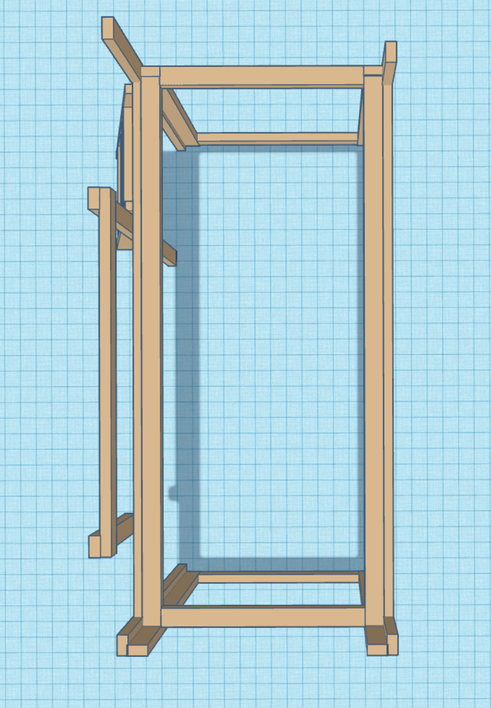

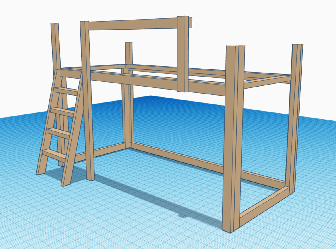

In regards to Tara's project above, I've put together some renders of how she might have assembled her frame.
