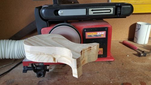

The headsets we have at home are fairly heavy, so I needed a chunky stand. Using a jigsaw I cut out two of the shapes which would be glued together to make up my thickness.
I am not very accurate with a jigsaw and my projects tend to cut at a slant. To resolve this issue I cut slightly outside the lines which would be sanded with a bench sander. Using the benchtop sander the excess was sanded away using the template line as a guide.

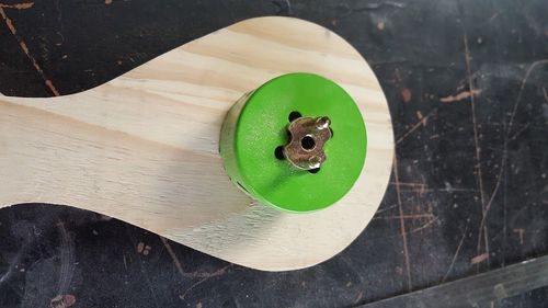

The centre was marked out and using a hole saw attached to a drill the middle was cut out.
To get a nice clean edge only saw half way through then turned over your project and drill out the hole completely from the other side. This will prevent the wood from blowing out and gives a nicer finish.

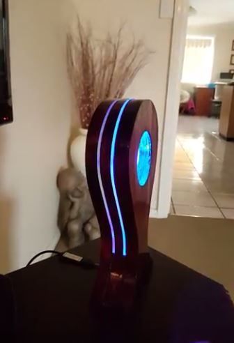

I have since made another headphone stand for my husband with LED flashing lights.
