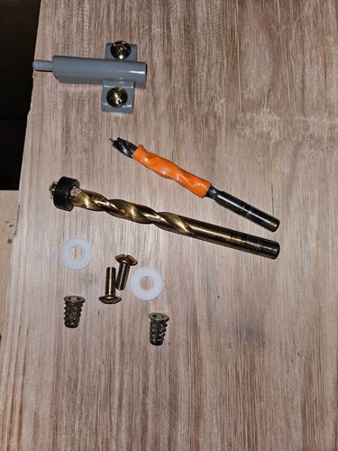

My last job for the night has been to fit one of the Stops that will receive the bed frame when it is put back into the cupboard
I am sure these are too close to the front but they are fitted according to the plans. All they do is spring back.
