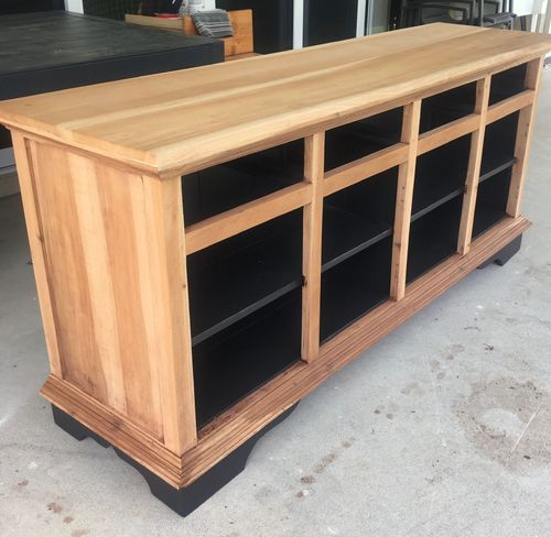

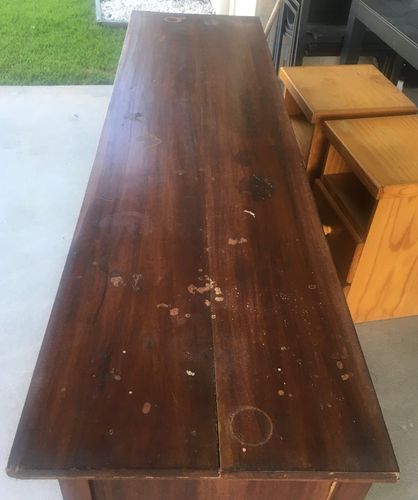

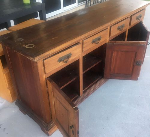

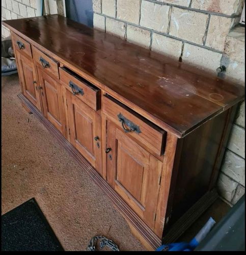

$30 on Marketplace! Lived outside for two years, full of mud wasp nests, water damage. I could still see her potential.

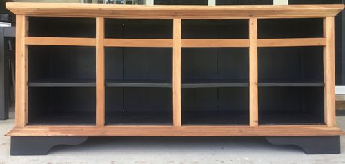

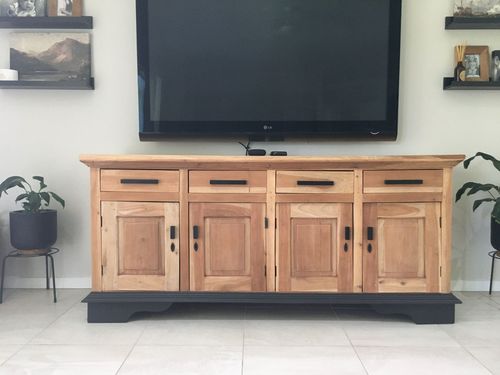

Stripped, sanded and sealed I knew she was pretty!. Handles made using dowel from Bunnings also.

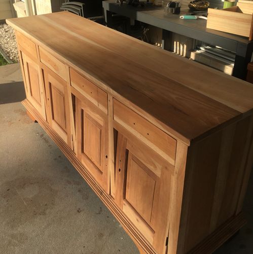

How long did the buffet take to sand back? What were some of the lessons learned during this project that you could share with the community?
Re: Buffet makeover
Thank you Jason ☺️
I stripped this piece first, then sanded. It took a good full day to sand this back. Starting with 60grit and ending with 220. I kept the sawdust to create my own filler to fix the water damaged areas on the top.
My lesson learned is to take my time and don’t rush.
