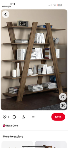

I want to build something like the one in the photo. What thickness panels should suit best and what would be recommended screws to use? Thank you.
Re: How to build a corner bookshelf?
Hi @moeenq,
You could use Specrite 1800 x 405 x 18mm Timber Multi Use Pine Panels as the shelves and 140 x 19mm 1.8m DAR Pine Premium - 1.8m as the uprights.
I'd recommend you glue the joints with PVA wood glue and then screw the joists with Zenith 10G x 75mm Gold Passivated Type 17 Countersunk Head Timber Screws.
