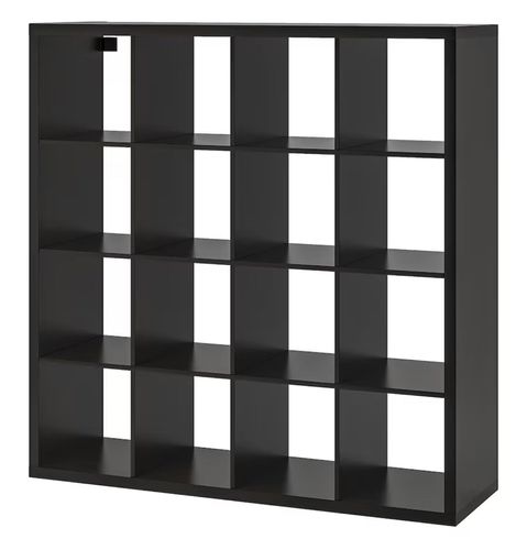

I have an existing Kallax unit from IKEA that I am looking to repurpose as a room divider in a granny flat.
I would love to pop in some drawers etc and I saw that Bunnings have them available for their cube storage units, and so I was wondering if anyone has fitted these Bunnings inserts into an IKEA Kallax unit?
I am aware that I could buy a new unit from Bunnings + the inserts, but I already have a 16 cube unit and to replace it, that is an additional few hundred dollars to do so.
The cubes in the Kallax are 330 x 330mm which appears to be similar to Bunnings but I just wanted to know if anyone has done this successfully, as I would prefer to not have to rebuy a new storage unit.

I have attached a photo of a stock Kallax unit just in case you aren’t aware what I am referring to.

Most of the Flexi Storage inserts will fit as they are slightly smaller than your 330 x 330mm. Your best bet would be to pick up a single cube and do a test fit on your unit. If it doesn't fit, you can always return it.

Although our inserts at 330mm would likely fit, the drawer unit at 335mm might not. It's 5mm larger than the space in your unit, so it doesn't sound like it would fit. The doors are 330mm, so there's a good chance of them working.
As mentioned above, I suggest purchasing a drawer unit and door and trialling them. If they fit, fantastic; if not, you can always return them.
