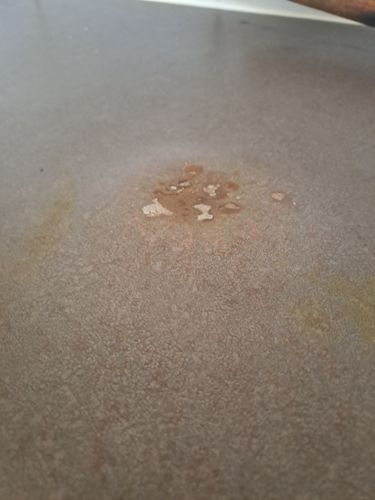

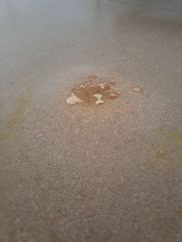

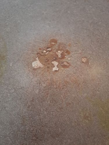

My kitchen top is burnt and need to repair it, please give suggestion. It is kind of bubble and some lamination color is removed.
Please find attached picture.

I'm sorry to say, It doesn't look like there's going to be a good way to repair this.
In other situations, such as How to repair burnt laminated benchtop? I have recommended using a combination of sanding, filler and paint to repair burnt benchtops, but unfortunately, the area that is burnt is quite large and the benchtop appears to be raised. Any repair you make to this area will be so large that it will be very obvious.
Unfortunately, the only way I see of getting a high-quality repair is to replace the benchtop.
