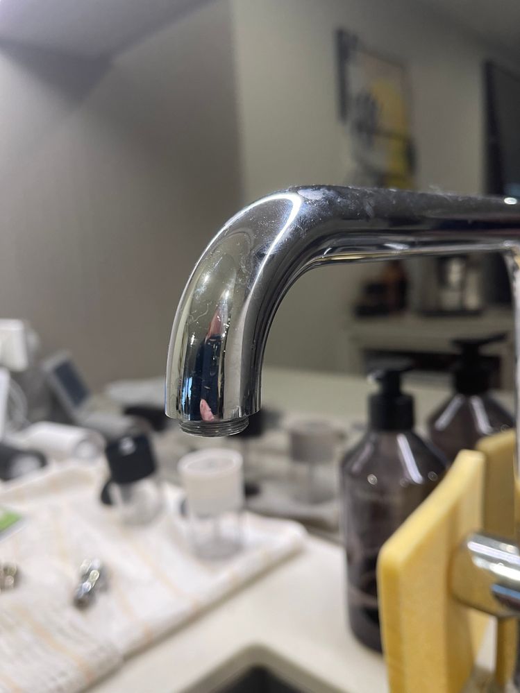

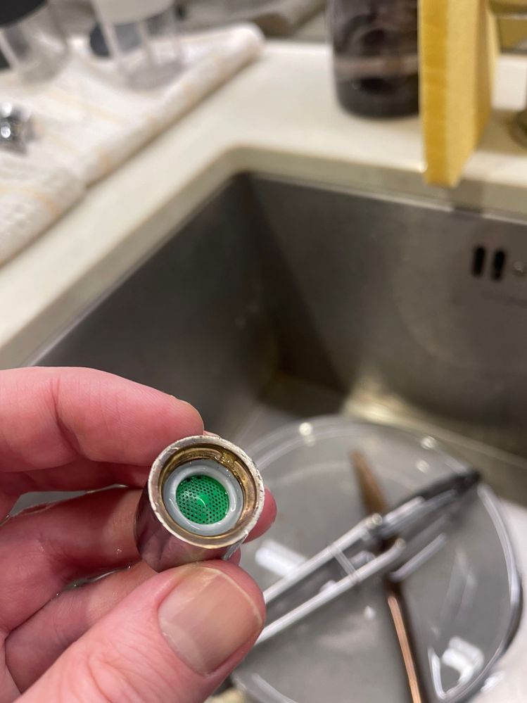

so I got the adaptor you recommended and it still doesn't fit.
My tap seems to have a very short connection point. Here are some photos. If you have any other ideas that would be helpful.
Re: Indoor tap adaptor for garden hose
Hello @gthom
Thank you for sharing those photos of your kitchen tap. Jacob's recommendation regarding the adaptor was actually correct. However, your tap is non-standard and will not work with the recommended Kinetic adapter. I suggest re-installing the aerator back on and using the Holman 12mm Plain Tap Adaptor With Clamp instead. This adapter works without a threaded end. Please note that it's best to keep the tap at low pressure to avoid blowing the adapter off.
Your other choice is to change your tap into something with a standard sized aerator or install a bypass tap under your sink connected to the cold outlet.
