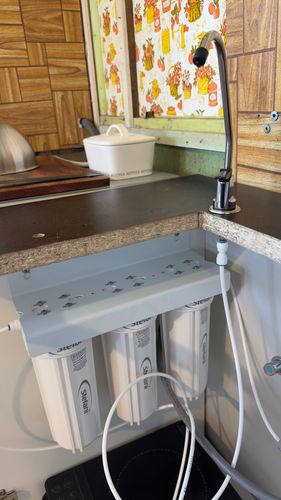

Hi @MitchellMc ,
The Stefani Triple filter is installed and filtering like a beauty. Thank you @EricL and @MitchellMc for helping me to learn about filtration and to end up with the system that works best for my situation, I appreciate it wholeheartedly.
Triple Undersink System With 0.2 Micron CartridgeTriple Undersink System With 0.2 Micron CartridgeIn-situ and Going Great So FarIn-situ and Going Great So Far
