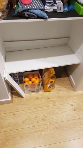

Hello,
I want to repair my bottom pantry shelf back to its place as it came off the other day. Wanting to know what size screws and wall plugs I should use to fix it against the plaster wall in my pantry. See photos attached.

For the pantry shelf, I would advise you to use Ramset Wallmate Twist-N-Lock 4 Pack fittings. You'll need to predrill each support with two holes to accept the screws. Insert the screws into the support piece and match it up into the position it was in prior to falling off. Press the screws through the supports holes so they make a small indentation on the wall and this will show you where you need to install the white plastic fitting. The white plastic part simply screws into the wall with a screwdriver. Once the white fittings are installed in the gyprock wall then the support and screws can be fixed into place. Each of these Wallmate fittings can hold up to 20kg so they will be more than sufficient for the shelf.
You might like to take one of the supports with you just to see the length of screws in the Wallmate pack. Because you are going through a reasonably thick piece of timber it could be worth using slightly longer screws like the Zenith 8g x 50mm Gold Passivated Countersunk Rib Head Chipboard Screws 50 Pack instead of the ones supplied in the Wallmate pack.
