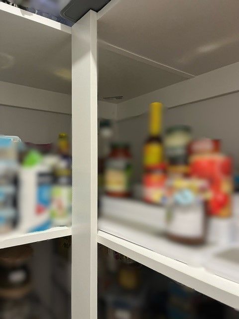

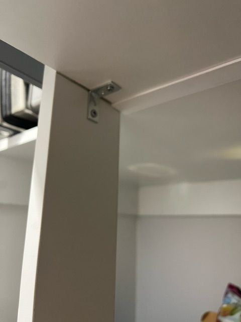

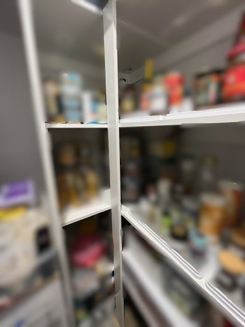

I have an L shaped pantry. It looks like the L is made of 2 separate pieces with a plastic piece joining it. And was strengthened by this vertical board that runs from top to bottom. Problem is the vertical board is in the way of me accessing the things on the shelves. I want to remove this vertical piece. How do I strengthen the shelves then? Better still if I can reuse the vertical piece. Thanks.

Mmmmm thats a "yeah, nah" answer You pretty much have two options. As @EricL mentions with the right angle brackets from the wall to support the shelf or shifting the verticle piece towards the photographer. The verticle piece atm is supporting all the weight on the shelves, that plastic piece is doing a good job but I really dont trust plastic as a support
Another option is a right angle bracket screwed on the underside of the long side of the shelves. Steel Angle either steel or alumiunium. You would still need that verticle piece but you could have it half way along the shelf instead. If you run it along the long shelf then across the short shelf then it will also help with that plastic join down the track. In theory you could do that right angle support on every shelf and even do away with the verticle piece, just need to make sure that all of the right angle is screwed to the shelf solidly so no flex is in the shelf.

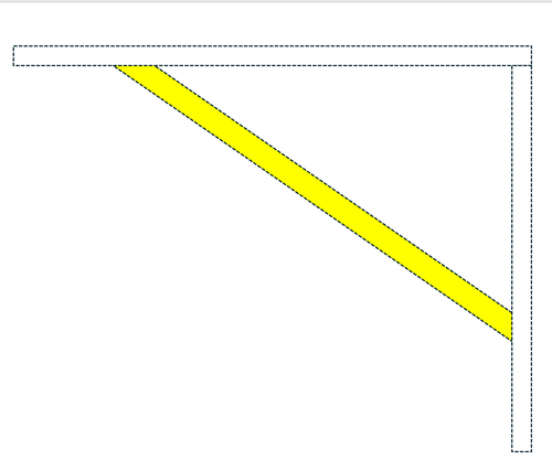

Hi @redcamper, both @EricL @and @Dave-1 have offered great solution ideas which would work well. Heres another idea to consider.
If you fix a cross member piece diagonally across each wall support, that will replace the need for the vertical stays. I've done this successfully on a few corner pantry fixes. It's a quick easy and cost effective fix. 42mm x 19mm DAR pine would work or the next size up for heavier shelves. Additional strength would come from single price shelves over two piece.

Hello @redcamper 👋
So many great suggestions thus far, I especially like the suggestion made by @Dave-1 to support the leading edge of the shelves, this could also be achieved with a timber support frame (as in the attached image) or alternatively you could partition the shelves with uprights as this would provide adequate support and permit the deletion of the current support upright, the down side is you would lose the "open plan" style aesthetics.

Hi @DIYGnome , I like the open style look on image that you attached. What kind of timber do I need to achieve this? For the short piece that runs across the shelf, how do you attach it?

Hello @redcamper
You can use whatever timber you like to construct the timber ladder shelf support, the picture below nicely illustrates just how the frame supports the shelving, this particular build was completed by Angela Marie @https://angelamariemade.com/how-to-build-corner-pantry-shelves/
