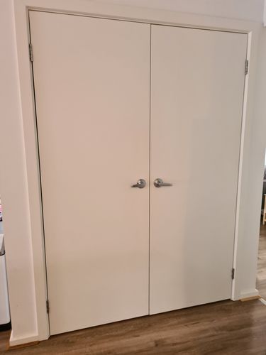

Pantry door glow up
All materials from Bunnings!
Super easy, inexpensive way to fancy up your doors
Instagram - lifewithsonnyjade

What an amazing transformation that is! It would be great if you could share some details of how you attached the moulding to the door with our members. I love your choice of handles as well; they're my favourite.

Wow @sjloves  I'd love details of the product you used and how you attached it.  This would be amazing on every boring 1995 door in my townhouse!

Welcome to Bunnings workshop community. That upgrade really makes it so much more stylish, I've always seen this type of make over but have always wondered about distancing. How much space to do I provide at the sides and top? Is there a fixed rule or do i just say " this looks good" and glue and nail it where I think it will look best? Like the other's said i too am curious to what you used to fix the panels to the door. Did you do any prep work before you attached it? My apologies for the many questions, we would be very much interested to know how you went about it. Any advice or tips you can give would be very much appreciated. Thank you so much for sharing your diy project with the community. We look forward to your future projects and if there is anything we can help with please post it here in workshop.

So we attached the skirting with a fixing gun! Some people use gorilla glue or something similar. After they were attached we filled the holes with no more gap, sanded them and painted them in vivid white.
We filled where the previous handles use to be so we could change the handles and hinges to black

We used plain skirting in white! And just filled the joins  sanded and painted. There's alot of different styles and mouldings and some people even use quad in heaps of different shapes and designs

We completely made ours up! There's no rule but with wainscoting or paneling, people usually do the bigger rectangle on top and use curved quad.
We wanted to modernise ours so used plain square skirting and just randomly chose our design. You can search pinterest or google for door panel designs and choose from there or just completely wing it like us 😊
There was no prep work, we just used a fixing gun to attach but alot of people use glue or silicone. We then filled the joins and holes, sanded them back, caulked the mouldings and them painted them. Super easy
