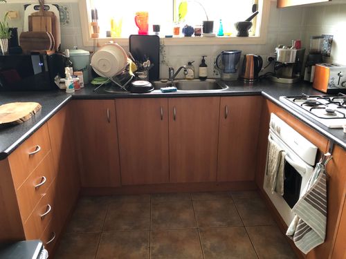

Hi community!
Looking for advice on the Dulux Renovator Range to paint wood cabinet doors. Would love to know what the difference is between the whites and what other tools are needed to complete the project. This is the current state of them.
Many thanks

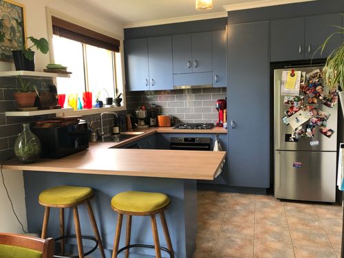

@Caron - I painted my laminate cupboards and they came up well (not as nice as @stevem's kitchen though !).
Here's a before and after.  I wasn't brave enough to paint both sides at the same time so the job took me four half days altogether.  I did this three years ago with White Knight Laminate and Tile paint.  My kitchen is 25 years old, all in good condition just ugly colours.  I did two coats and it's lasted well, though we don't have kids.
Definitely do a trial and learn on the back of one of the cupboard doors, but otherwise I found this an easy job if you're capable of removing and replacing door hinges and handles.  I used a roller and a brush for the awkward parts.  About $250 all up.

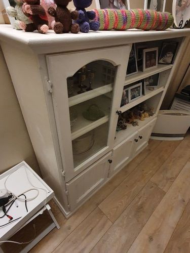

This was an old wooden TV cabinet that I turned it into a sorta display cabinet and painted with Porter's chalk and a polyurethane finishing coat - "no preparation required".
Not sure though how durable it would be on wooden kitchen doors?

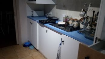

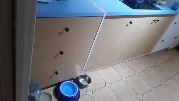

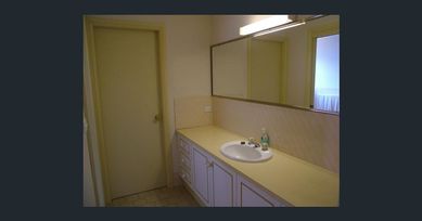

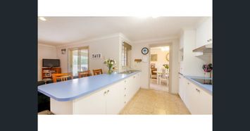

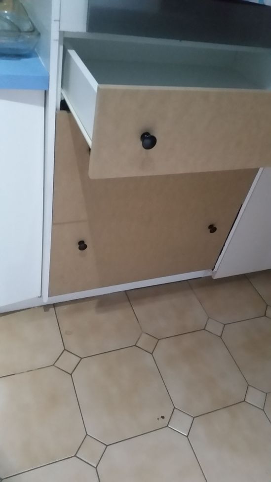

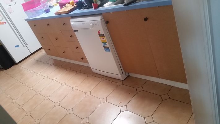

Painting kitchen *(bathroom )cabinet doors

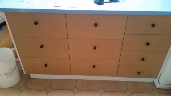

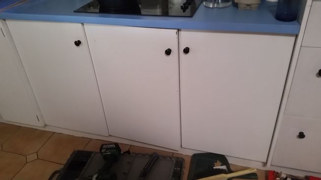

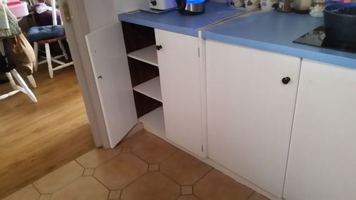

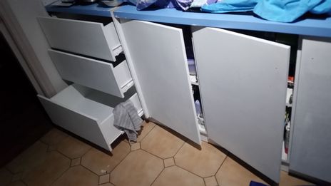

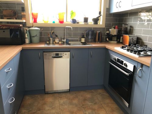

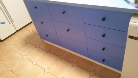

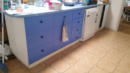

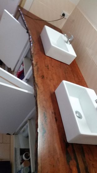

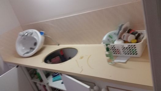

@Ari   Doesn't it give you such a buzz, that self satisfaction feeling of doing something your self when you look back and it's all done?  Looks great.  This is what I've been doing with my bathroom and kitchen. Slow but steady..
I changed the way I was going, a little as with my kitchen as it's old, but still in reasonable repair.  I'd planned to paint the cabinets and replace the bench tops.  Most of the kitchen cupboards are either too high of to hard to reach.  So half of the cupboards are now draws for ease of use, which I've painted most of. Still have the cabinet doors to paint.  They've been replaced with MDF so could paint with gloss paint, no fiddling about.  Still have lots to do.  Haven't got the bench tops finished but the bathroom ones came up a treat.   This what I did with my bathroom vanity area first, replace large bench top and bowls and took out massive mirror, replaced with smaller round ones and repainted the tiles.  I still have the cabinet area to paint but can't decide on the colour so went on with my kitchen.
Before make~overBefore make~over

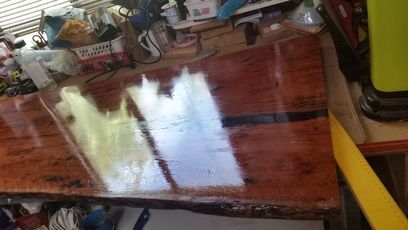

BeforeAlmost readyAlmost readyPreparing the live edge slab.
Looking good  :)Looking good :smile:
Ripping things outRipping things outRipping out the old vanity top
Opps upside downOpps upside down
Kept the cabinets as they are dated but in good nick ~ will paint at a later date.upside down but you can get the gistupside down but you can get the gist
 Bench tops and new taps and bowls installed.  Have since put up new mirrors and painted the tiles.  Still have cabinet doors to paint ~ still trying to pick a colour.  :smile:
Now the kitchen, still very much a work in progress.

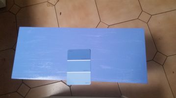

Before ~ looks great, but sadly painted with house paint and most of the paint has worn off in patchesBefore ~ looks great, but sadly painted with house paint and most of the paint has worn off in patches20200914_233657.jpgChanged space under oven to drawsChanged space under oven to drawsDecided to change cupboards to drawsDecided to change cupboards to draws20201105_145549.jpgDraws made from MDF easy to paint after sealing.Draws made from MDF easy to paint after sealing.Decided to replace the door fronts with new MDF also.Decided to replace the door fronts with new MDF also.MDF draws and (door fronts) into where I mostly had shelvesMDF draws and (door fronts) into where I mostly had shelvesCut out the small cabinet that held the jug and toaster to give me more flowing bench space ~  When I get the new bench tops completed!  Work in progress.Undercoat - sealerUndercoat - sealerUmm more purple than the blue I'm looking for so back to Bunnings paint section.  They are amazingUmm more purple than the blue I'm looking for so back to Bunnings paint section. They are amazingNow this is more the colour I'm afterNow this is more the colour I'm afterVery happy with the colourVery happy with the colourShould look good when I get the live edge timber bench tops in.  And paint the rest of the cupboard doors.  Just a bit over painting and prepping right now.
