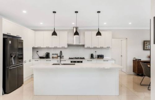

Before picture:

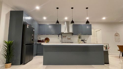

Final result:
Some more:

Step 1
1/7Step1: We took out all the cabinets doors and their handles
Step 2
2/7Step 2: We applied masking tapes behind the cabinet doors, on the wall corners and floor to protect unwanted paint
Step 3
3/7Step 3: We did sanding to all the cabinet doors and Island to make them even and throughly cleaned the surface later
Step 4
4/7Step 4: Then we applied one layer of primer using roller brushes and left it for drying overnight
Step 5
5/7Step 5: Later we applied the first coat of Dulux Renovation range for cabinet doors in Signature colour and again left it drying for around 5-6 hours
Step 6
6/7Step 6: Upon drying first coat of paint, we did bit of sanding to even out the paint, cleaned them and applied second coat of paint, left it to dry for around 5-6hrs
Step 7
7/7Step 7: Finally we removed all the masking tapes from the cabinets doors, cleaned them and fitted it back to the shelves. Also removed rest of the tapes from wall corners and floor.
