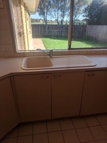

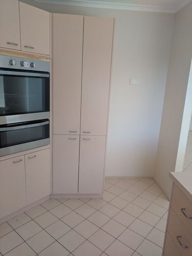

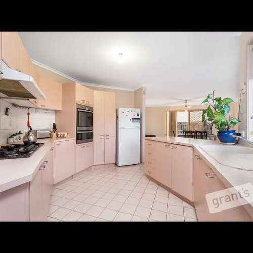

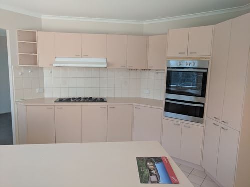

This is my first major DIY project. I'm wanting to update the kitchen, and after lots of research I plan to paint the kitchen cabinetry and carcases with Dulux Renovation range, however I'm not sure how to tackle the bench tops given their "unique" design
I'm wanting to keep this project as low cost as possible (unfortunately this house was a rental and has been handed back to me in poor condition, so many other maintenance projects have set my budget back a bit)
The sink and tap-wear we're replaced beginning of last year with Chrome fittings, and a stainless steel dishwasher to the right of the sink (sorry about old photos)
Do Bunnings make custom benchtops to suit this style, or am I better off painting the laminate?
Has anyone used a spray gun to get a glossier finish?
All advice welcome, I'd really love to start sanding in the next few days once I know how to approach the benchtops

Hello @SaraKearney
In order to get the most bling out of your budget I agree with your decision to use the Dulux renovator range! You can use the same range for your bench top. Using a spray gun is a good idea, but if this is your first attempt, I suggest getting some practice first with the house fence and some exterior paint. A few projects under your belt will give you the confidence and knowledge to attempt to spray not only your bench top but your entire kitchen! Investing in a spray gun will open a whole new world of possible renovation projects. However if time is of the essence then use a high quality paint roller for your project for a superior finish on the paint. However if you invest in a spray gun go for a mid range unit such as the Wagner W100. A good starter unit for you and will pay for itself when you do your first furniture renovation! Good luck and please post when you have finished your project I look forward to the reveal!

Hi @SaraKearney,
It's great to see you've already received a helpful response from the knowledgeable @redracer01.
How are you going with your project? It would be worth popping into one of our stores and discussing your custom bench top needs with one of our special order or kitchen experts. I don't believe we have a service which will assemble the entire benchtop and deliver it to site. However, they might be able to do some of the angular cuts you'd need to join the rectangular benchtops.
