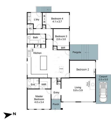

We're planning a kitchen renovation but feeling a bit stuck with the layout. Our goal is to make the most of the space and create a functional, efficient design.
Our current kitchen is quite small (approximately 3m x 3m), so we're considering incorporating some space from the adjacent bathroom to expand the kitchen area. I've attached the existing kitchen layout and measurements in a CAD drawing, along with the proposed new kitchen area. We'd really appreciate your help in designing a layout that maximizes both space and usability.
Please note that all dimensions in the CAD drawing are in feet.

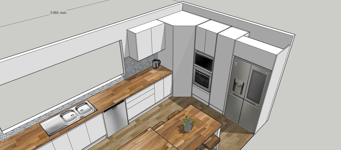

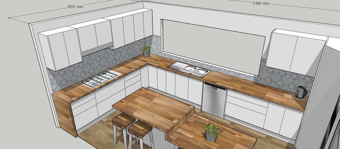

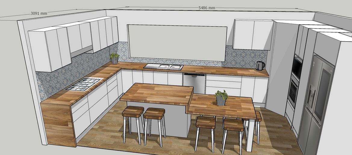

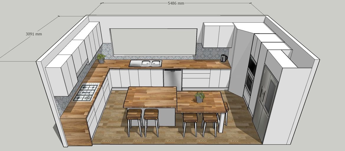

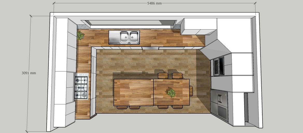

Re: Need help with kitchen layout to maximise space
Hello @diva9
My apologies for the delay. Here is the new layout with the bathroom space included. If you would like to see it in another configuration, please let me know.
diva9 kitchen A7.jpgdiva9 kitchen A6.jpgdiva9 kitchen A5.jpgdiva9 A4.jpgdiva9 kitchen A3.jpgdiva9 kitchen A2.jpgdiva9 kitchen A1.jpg
Thank you so much @EricL ..that's amazing
