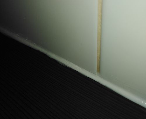

Next time I'm hiring someone, but YES I did do the seal and although it isn't the finishing professional look I wanted I think it is definitely sealed and looks fine if not looked at too closely.

1) The scrapers proved rather inefficient/ineffective and I ended up having to use my finger and water with a drop or two of dishwashing liquid in it.

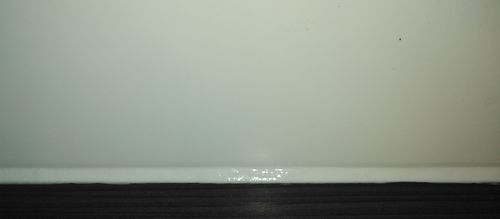

2) As for the professional caulking gun I bought - the bench went deep at one end so balancing on a stool proved rather tricky to form one bead line properly - had to go over it a bit again which wasn't in my plan. (Photo 2)

Photo 1: Fine.
Photo 2: Off a Bit.
Fine though as the dishwasher is being put here so its not like it will be seen. A few parts like that, but from a distance not too obvious. This is probably the most noticeable section and can likely be cleaned up, but I'm not sure I want to attempt.

That looks perfect, @MinB, and I think you are being a little hard on yourself. If someone told me a professional did that caulking job, I would not for a second question it. I did a quick inspection for my mother of an apartment she was purchasing before the sale. The caulking was nowhere near as nice as yours. There were no continuous caulk runs, just short sections overlapping each other, which changed from thick to thin to thick again and was generally horrendous. There were even sections they had failed to cover altogether.
I know for a fact that your job is far better than my first attempt, and I would struggle to get it as neat as you have done even now.
Many thanks for sharing your update and experience with us all.
Well done!
