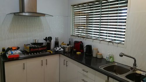

If you r still thinking, my first thought was glass--I figure it'd be easier to clean than tile grout. However, when I redid mine I opted for tiles because I have a gas hob & glass required additional heat insulation plus the gas required additonal clearance to the exhaust fan meaning the standard glass panels wouldn't fit. I found some 900x300 tiles to minimise the grout lines (& cleaning). I chose gloss white because i got the cupboard doors 2PAC'd in gloss white. Turns out they were better than anticipated--they have a nice wavy pattern that, when the lights are on, throws patterns of light onto the (black granite patterned gloss laminate) benchtop for an extra touch. I've included a small photo below (the benches are cluttered with cooking prep for Xmas). I used the same tile as splashback around the sink etc using the full 900mm but in hindsight they look out of place except behind the cooktop. Cheers, Peter
900x300 tile splashback

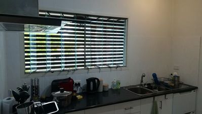

Here's some photos 😊 as requested--definitely not a magazine photo shoot quality. As you'll see, I have a window over the benchtop too. I kept the tiles vertical & cut them down to fit. Bcos there was no exposed edge, I used both ends of a cut tile so only used 1/2 as many for that area, saving some $ 😃 At the right edge of the window thru to the side wall (see 2nd photo) I used full tiles that don't appeal to me. I think I would've preferred keeping them the same height as the base of the window (about 300mm). BTW, the walls are 2700mm, which I think is why I decided to use full tiles. And a tip: make sure you don't end up with narrow tiles--the tile at the right edge is about 40 mm beside the window & cracked thru as the house moved. I should've aligned the tiles to have a full width tile. Also, the cupboard doors look yellow in the photo but are gloss white in real-life & a good match for the tiles. Happy decision making...
Cheers, Peter
Looking towards cooktop
(in case you r wondering, that's a tray of mangoes on the cooktop, & a sifter & tray for a brownie slice)
Looking away from the cooktop

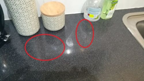

Light reflection from tiles
Trying to show the light reflecting from the tiles...more obvious at nite.

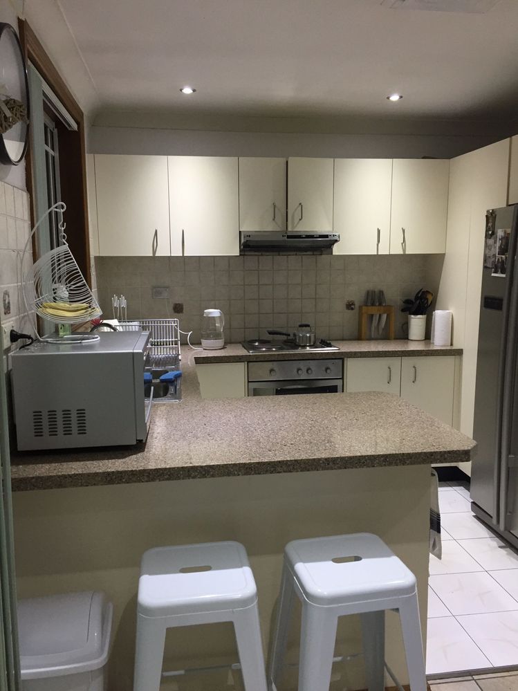

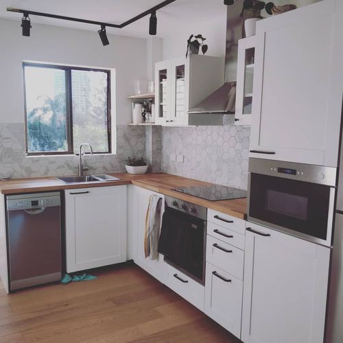

Not sure if you can do this with kaboodle but I would suggest to keep the microwave in the tower, but put the oven under the cooktop. This would allow to move the microwave a little down, I think the suggested height is too high. I'm 172cm and our microwave is the bench level, see photo below. An alternative is to put microwave under bench level on a blind shelf if that makes sense, of course if you have small kids this could be out of question
Regarding the range hood, you want it higher than your cabinet level for 2 good reasons. 1, cabinets are at a lower level so you can reach them. You're not grabbing anything from the rangehood. (Unless you have a little shelf.sitting in front of the range for spices)
2. The area of suction will be actually bigger if you put it higher. So it's not a direct tunnel between the cooktop and the range, it's more like a trapezoid that the range can suck away. the lower you move it the less area it covers, but obviously it has a height range it can do to stay efficient at sucking away hot air and smells.
My wife's about your height and the tower unit works for her, suits both as I'm 6'4. You just wouldn't want a pull down door microwave fitted a side door works. Check my post for a reference pic. Enjoy. God bless.
