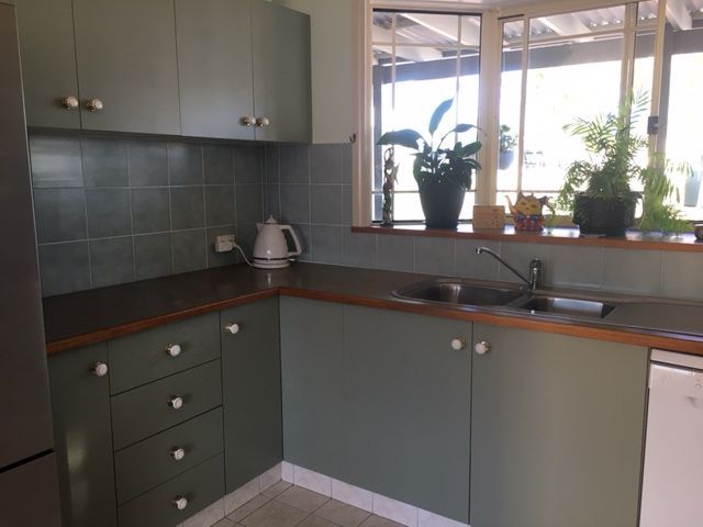

Clean and remove old grouting.  Sandpaper lightly, clean, clean again.
Next Step
Step 2
2/6
Apply sealer, with micro small roller (as per recommendation)
Previous StepNext Step
Step 3
3/6
Apply two coat of colour, leaving 24 hours between.
Step 4
4/6
Apply two coats of top satin coat, leaving a day between

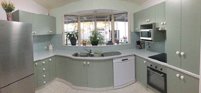

Panoramic picturePanoramic picture

I also applied the Dulux Renovation to the bay window, came up a treat
