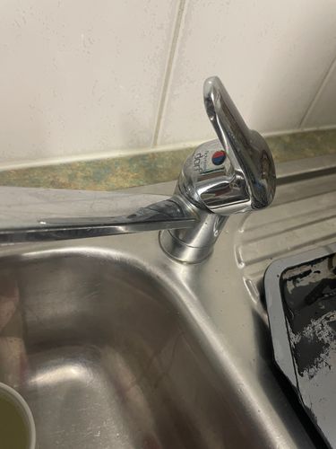

Hi,  I’m in a rental property and have an issue with my mixer tap in the kitchen “spinning”.  There is a knack to actually getting the tap to full hot, see attached photo and video.  Any help would be greatly appreciated as I would like to fix it myself.
Q2. Also it has just started dripping, and assuming it’s dripping because of a washer, but where do you find the washer on these things? I’ve changed bathroom tap washers before, but never a mixer tap.

I've had this same issue before, and it is relatively easy to fix. Underneath the sink, there should be a thread with a nut on it. You will just need to line the base of the tap up with where you want it and tighten up the nut with a shifter.
To fix the drip, the likely best solution is to replace the mixer cartridge. The hot/cold indicator on the handle can likely be popped off to reveal a grub screw. If you remove this grub screw, the handle will come off to reveal the mixer cartridge.
You can then follow this handy guide from our supplier Fix-A-Tap on How To Replace a Mixer Cartridge to replace the cartridge
Let me know what you think and if you run into any trouble along the way, please don't hesitate to ask.
