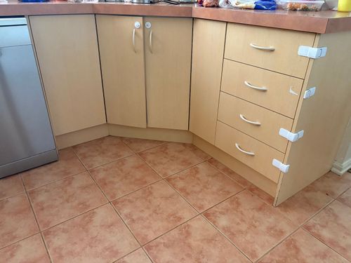

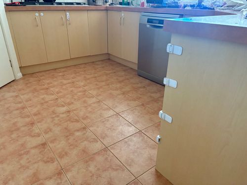

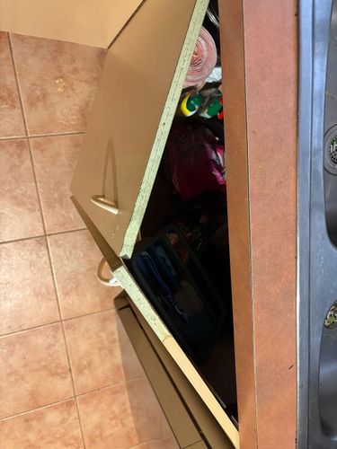

I have kitchen cabinets that are around approximately 24
years old. I’ve attached some photos so you can see the condition and colour of the cabinet doors. I’m hoping to give them a bit of a refresh—mainly the doors, drawer fronts, skirting, and partition fronts—without spending too much.
Do you think it’s practical to use wallpaper from Bunnings to wrap the doors and other surfaces? Or would painting be a better and more long-lasting option? I’d love your advice on the most cost-effective solution, or whether it might be worth looking into replacing the cabinet doors and drawer fronts altogether.

I'd suggest painting them, as it is a tried-and-true method of restoring aesthetics to cabinets and structurally your cabinets look ok.
You can use the Dulux Renovations range of cabinet paints. They are a specialty paint system designed to update laminate, melamine, and timber cabinetry. Start with a coat of the Dulux Renovation Range Primer followed by your choice of topcoat to finish.
Check out Rejuvenate your cabinets with Dulux paint and How to Paint Laminate Kitchen Cabinetry for some guidance on the process.
