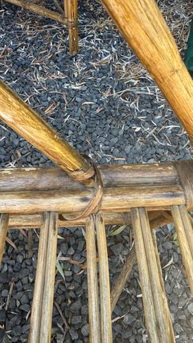

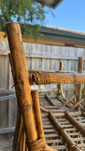

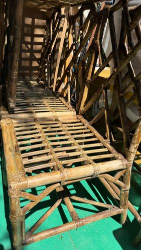

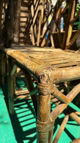

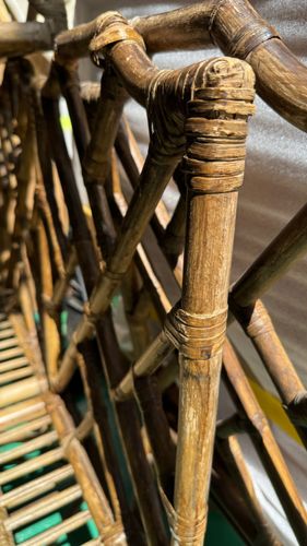

Just got a set of very vintage dining chair but they need big TLC job done as the paint and chair joints start to lose.
my question is:
1) What products do I need to paint them back like original color.
2) How to fix the joint between the chairs.
I attached photos then you can see better. Thank you all
Re: how to TLC the bamboo dining chair
Hi @Thaobui,
To stabilise the joints, you'll need to use PVA glue along with nails or screws to reinforce the structure. Once the joints are secure, you'll want to recreate the original look by binding the corners as they were before. If the chairs originally used bamboo lashing, you’ll need to find a suitable source for it. Alternatively, jute cord can be used to achieve a similar aesthetic.
Once the joints are restored, you’ll want to refinish the chairs with an appropriate varnish. If they’ll be used indoors, an interior varnish will work well, but for outdoor use, an exterior varnish is best. Before applying the varnish, use 240-grit sandpaper to remove any deteriorating or flaking coating to ensure a smooth and even finish.
