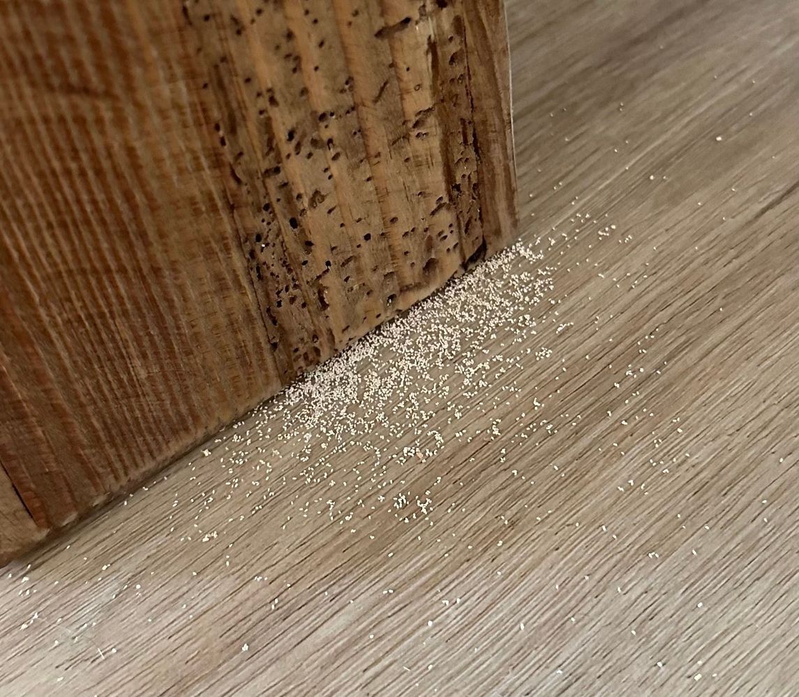

I have an upcycled solid wood table (treated) and I have owned it for 9 months. I recently noticed circular/powdery deposit at the base of two of the table legs. They look like wood borers. I have not seen any wood borer though. I would like to ask if this is indeed the work of wood borers and which is the best product top treat it? Thanks!

Thanks @KatieC for looping me in. Hi @MelanieKS
Sorry to hear about your problem. Borers are hungry and this will get worse if you don't treat it straight away. The sawdust you can see is actually the Frass, its what appears when the borer form of the insect develops and eats its way out of the wood that their larval form are living in. By the time you see the frass, the insects have emerged so hard to control then. Looks like you have a good infestation there, so it is still worth treating.
I work for Bunnings, and we sell this product which I think you could use to treat the problem: Hovex 2L Termite Defender - Bunnings Australia.
I would be taking it outside to treat if you can and always read the instructions and wear the recommended PPE. Give it a good spray as directed BUT I would be doing a little test spray on a bit of the wood that is not obvious to ensure it doesn't mark/colour the wood.
Finally - you may need to treat more than once depending on the infestation and don't be surprised if you see more frass until you have completely controlled the infestation. Good luck.

Hello @MelanieKS
It's great that you've received excellent advice from @robchin. Just to add to the suggestions made, I recommend checking the drawers and other parts of your table for borer infestation.
I propose using a small needle dipped in the Hovex 2L Termite Defender and piercing as many holes as possible with the insecticide.
Please make sure to wear personal protection such as gloves, goggles and a paint mask when handling the insecticide.

Re: How to treat wood borer?
Hi @MelanieKS,
I just wanted to clarify some previous advice that my colleague @EricL provided. As @robchin mentioned, please read and follow the instructions on the packaging and wear the required PPE when opening the container, preparing, and using the product. Those include wearing cotton overalls buttoned to the neck and wrist and a washable hat, elbow-length PVC gloves and a face shield.
Also, the approved methods of application are with a brush, roller, dipping or spraying.

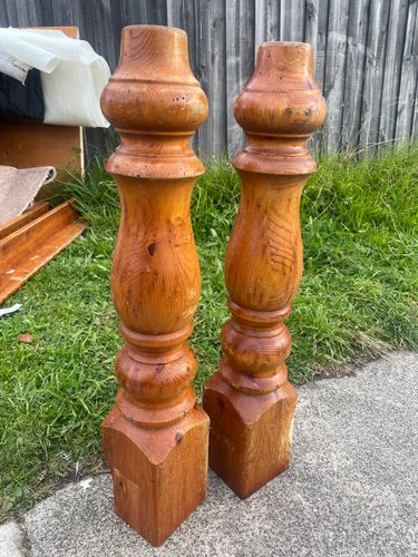

Some helpful tips in this thread already - piggybacking off it to ask about pet safety.
Context is, I found some excellent sturdy legs on a table on hard rubbish - which would be great to use in making a DIY cat tree - but it looks like they’ve had borers in residence. I currently have no income, so I’m looking for the cheapest option possible, but I also don’t want to use anything that may potentially leave a lingering hazard for my cats.
Any tips?
thanks!
