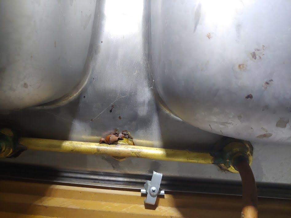

kitchen spout.jpg kitchen tap1.jpg .
How do you remove the lock nut on the existing spout -  see photo?  It appears that a basin spanner  jaws (www.bunnings.com.au/haron-280mm-adjustable-basin-wrench_p4901618) may not be able to fit in the tight space between the top of  pipe and the sink - estimated to be less than 4mm.

From your photos it looks like if you use a spanner (not an adjustable one) you may be able to get it in place to hold that nut and then undo the large nut on top.
More likely You may need to resort to wedging a large flat bladed screwdriver at an angle between the flat side of a the nut and edge of the sink to stop it turning then Undo from the top.
Another question tho, is the copper pipe connected to a fitting that you can disconect before it goes into teh wall/floor? If thats the case then Id undo the clasps that hold the sink in place and take the sinkl out to rowk on it. Crossing fingers this is the case for you.

Thanks for sharing your question about replacing your Dorf kitchen taps. For easier removal, I suggest dismantling the hot and cold taps first. Once the taps are loose you can then disconnect the copper pipes which will allow you to pull the "T" or Brasshards Breech Basin Tee off. Don't be alarmed, what you are seeing is true, the spout is only connected to the centre piece by friction of two O rings.
You can literally pull the "T" off and then you'll have access to the locking nut of the spout. Please make sure that your mains water is turned off and your plumbing system is depressurized to prevent accidental flooding.
However, if it is a threaded brass "T" connection, you should be able to unscrews the spout from the top connection. If you are no longer recycling the tap set, I suggest using a shifter to turn the base of the spout and see if you can unscrew it from above. I recommend turning the base of the spout anti-clockwise to loosen it up.

I will look into it .  @EricL photo does not show lock nuts, and I cant access the locknut.

I don't have a picture of the spout with the lock nut on it. But as I mentioned, I recommend removing the hot and cold taps first and then you'll have access to the lock nut under the spout.

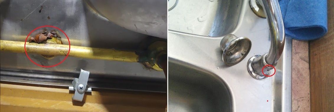

Hello @kn_ll looking at the images supplied your locknut will be exposed when you remove the T pipe as mentioned by @EricL should you wish to remove the spout section of the tap the area circled in red denotes the location of a Allen key grub screw which when removed will allow you to then retract the spout.
Looks like a large adjustable wrench (or Stilsons/Pipe Wrench) will be required to hold the top section whilst a large socket (or something suitable) will be needed to undo the lock nut, a second person would be handy.

Some feedback on my project- I needed 12 inch adjustable wrench to unscrew the taps.  I unscrew the grub screw from the spout and the spout then unlugs.  The spout hole was 26mm so I had to drill it out to 32mm.  The lock nut under the sink was welded to the TEE connection therefore only unscrew from the top.  Once unscrewed the Tee can be removed from under the sink.  The flexible braised hose that comes with mixer was too short by 20mm because the water connection to the sink was to one side, so I am off to Bunning tomorrow to buy a 50mm extension.
