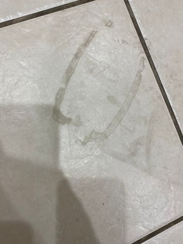

Anyone knows how to repair this tile? The tile’s color has changed even I tried mop and brush it, it doesn’t work, I guess if i need to repaint this tile? If yes, does anyone know what is the paint product should I use?

I'd suggest you start by using a cleaner specifically formulated for tiles such as Davco Tile And Grout Cleaner alongside a Heavy Duty Scrub Brush. Ensure you follow the manufacturer's instructions for use and wear all relevant personal protective equipment.
If you have no luck with this, you should check to see if any spare tiles are lying around. Tilers often leave some tiles in case one needs to be replaced, so it is worth checking. If you have any, you could remove this individual tile and replace it with another from the same batch.
If the cleaning chemical does not work and you don't have any spare tiles, I'd suggest painting the tiles with the Dulux Renovations Range system of tile paints. Ensure you thoroughly clean the tiles, and apply the necessary primer followed by 1-2 coats of your chosen paint.
