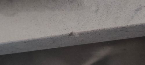

Can I please get advice on how to repair a chip, fill up a gap and polish my stone benchtops?
Please see photos attached.

Thank you for sharing your question about how to repair a chip on a stone benchtop. If you can identify your benchtop, I suggest calling the manufacturer and asking them if they have a stone repair kit available.  I usually suggest that if you still have the chipped piece that came off, I propose trying to glue that back on. You can also try using PC-11 56g White Epoxy Paste, however, the challenge here is trying to match the grey colour of the benchtop. If you misjudge the colour the repair will even be more noticeable.
Unfortunately, the gap in your benchtop is usually filled with grout with the colour of your benchtop mixed in. If you're willing to experiment, I suggest looking for a light grey grout that closely matches your benchtop colour. To polish your benchtop I recommend using Glitz 750ml Stone And Benchtop Cleaner. It is a non-acidic and non-abrasive cleaner that's safe to use on stone benchtops.

We had some chips on our white Ceasar Stone and for us, we asked our stone mason to do the repairs. Since we had white he just mixed up the adhesive, filled in the chip. waited about 30 minutes then he sanded it down. For DIY using a matched colour epoxy as suggested by @EricL is also a good idea. Good luck with the repairs.

It looks like matching the color for something like this will be a nightmare so after doing my research I found that the best way do it is getting a stone professional which I already found someone will hopefully come next week to reapir it (cost $300). which is a good price I think.
