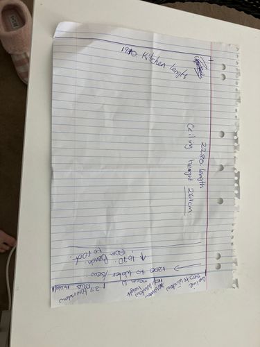

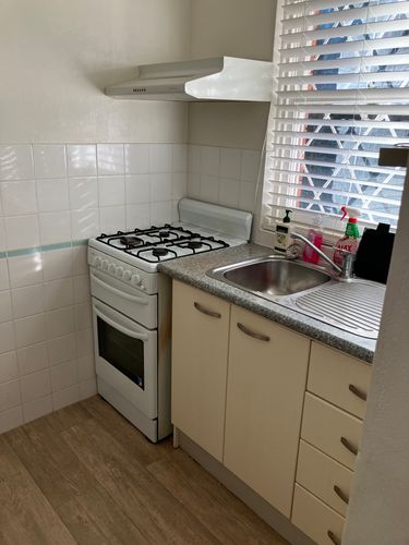

Thanks soo much Eric that would be very helpful.  It is galley at the moment and I was thinking U shaped to maximise space. I have a  wall to remove (I have engineer report) and quotes. This would give me more bench space, storage and a single dish drawer

I just wanted to double check with you on the floor plan you posted. The wall on the left is 1910mm, the one next to it is 2280mm, is the right-hand wall the same measurement 1910mm as well? What about the wall across the 2280mm how much of that wall is usable and where are the doors located? Once you give me these details, I'll be able to start drawing your kitchen.

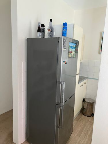

Thank you. I probably didn’t make it clear. The left wall is 1910, the back wall is 2280 the right one (with the window) will be 1918 right to the external doorI am going to open the area up by removing the wall beside the external door (with the shelves and spices) so it will be an open a u shape facing the living room. It is structural and I have the required report and quotes, approval to remove it.  There will be a 2330 u80 beam running between the left and right walls where the 2/3 wall is now (with the shelves across from the fridge). It’s a bit of a tricky space to fit everything in as I would like to keep a 600m fridge 🙂. Thank you again.

Thank you for your patience. I've placed the sample kitchen layout below. Please have a look and tell me if I have it facing the right way. If not, please tell me the correct position and I will redraw it for you. My only other request is can you please measure the distance between benchtops.

Thank you!  Sorta there I think. The wall with the oven is wider 2280 and the one with the fridge is1910 and the sink is 1918, so I think they are both shorter than you have drawn. Just one thing missing too is cutlery drawers, as much as I would love the pantry I don’t think it’s possible to do drawers on the bottom with a smaller pantry?  Thank you again it looks good. And shows me how it could work. Justine
