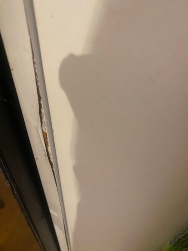

About a year ago I painted our kitchen with the dulux laminate range paint. There is now one small section where the laminate appears to have peeled. What is the best way to fix this?

I suggest using Selleys 100ml Kwik Grip Horizontal Contact Adhesive to join the laminate back onto the timber board. I propose using a thin applicator like a popsicle stick to spread the adhesive on the board and laminate strip. I propose using masking tape to temporarily hold the laminate in place until the adhesive cures. Once the adhesive cures you can then remove the masking tape.
Please make sure to wear personal protection such as gloves, goggles and mask. Please make sure to follow all the safety guidelines printed at the back of the packaging.

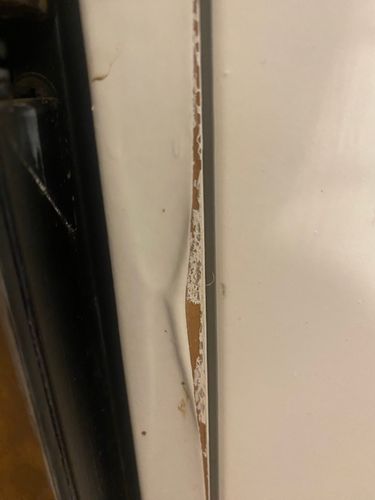

thanks so much. That sounds good for the part down the bottom but I am a little concerned as the top part almost seems to have shrunk!? I don’t think it will cover it if we do that? I believe you’ll still see the wood underneath.
any other suggestions?

Now that I've had a closer look at the location of that panel. You're correct that the panel wrap has shrunk and has moved back. I'm afraid I'm going to have to suggest replacing the damaged side panels of the oven. This type of damage occurs when extreme heat of the oven sometimes blows over the side of the panel.
It doesn't happen straight away, but the cumulative effect of heat exposure will eventually damage the vacuum wrap. If you are not yet prepared to change the panels. I suggest using the glue and covering the wood with some touch up sample paint.

I am unable to clearly see from the photo, but chipboard is likely to be what is under the laminate. It's a material that degrades rapidly under moist or extremely hot conditions. I would be inclined to rip the whole panel out and put in a panel that's got some heat resistant properties. Or to tile a sheet of gyprock and install that. Another option might be fibre cement panels. Heat resistant wall panels are also out in the market, so you might want to research that.

I believe @EricL's advice was to replace the whole side panel of the cabinet. Alternatively, you could remove the damaged vinyl wrap from the front edge, carefully cutting it away from the sides, and apply 21mm x 10m Melamine Edging White. This iron-on edging is considerably thicker than the vinyl wrap (fractions of a millimetre), but it could give an acceptable finish and prevent you from replacing the panel. Another option would be to remove the damaged vinyl and paint the exposed edge.
To replace the panel entirely, you'd need to remove the oven to gain access to the screws holding it in place.
