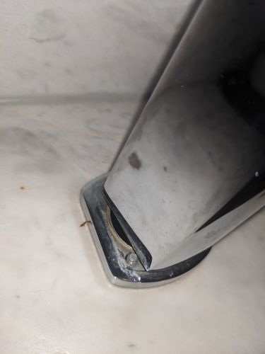

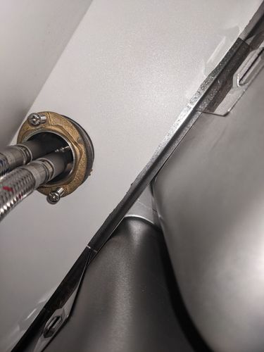

Can anyone advise on how to go about tackling this loose kitchen faucet, which appears to have come away from its base due to a loose screw. I attach a picture of the under sink and above sink sides.
Model is a Heston Kitchen Mixer BL2404.
All the advice online is about tightening the nut but the problem here appears to be a loose screw and I see no way of accessing this screw to tighten it.

I suspect you'll need to unscrew the two screws that can be seen in your first photo underneath the sink to allow the attachment plate at the bottom of the tap to be removed. This will likely allow you to lift the flange plate at the bottom of the tap giving you access to its underside. This should allow you access to the small grub screw that you can see in the second image.
Now you have access to this screw, line up the tap body with the grub screw and tighten it.
Once tightened, you can put the tap back in place and fix it back together with the screws on the underside of the sink.

Re: Loose kitchen tap
Thank you, that did it (along with unscrewing the pipes).
Much appreciated!
